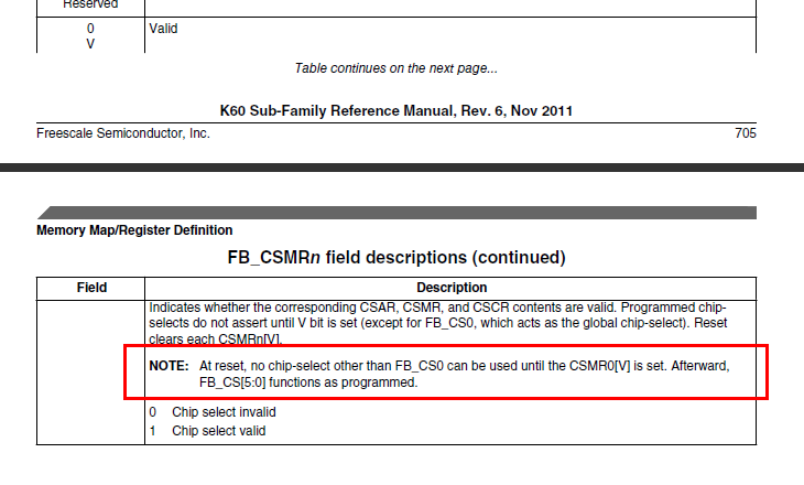

I am working on K60 evalution board, in flex bus configuration am able to cofigure fb_cs0 with range from 0x6000_0000 to 0x6FFF_FFFF;
But in same way trying to configure for fb_cs1 to fb_cs5 range start from 0x7000_0000 to 0x7FFF_FFFF (fb_cs1) it's not configured with
followin configuration
  SIM_SCGC7 |= SIM_SCGC7_FLEXBUS_MASK;
  //Set Base address
  FB_CSAR1 = 0x70000000;
  FB_CSCR1  =   FB_CSCR_PS(2)      // 16-bit port
              | FB_CSCR_AA_MASK    // auto-acknowledge
              | FB_CSCR_ASET(0x1)  // assert chip select on second clock edge after address is asserted
              | FB_CSCR_WS(0x1)    // 1 wait state - may need a wait state depending on the bus speed
  FB_CSMR1  =   FB_CSMR_BAM(0x1FF)  //Set base address mask for 512K address space
              | FB_CSMR_V_MASK    //Enable cs signal
   //enable BE signals - note, not used in this example
  FB_CSPMCR = 0x12200000;
  //fb clock divider 3
  SIM_CLKDIV1 |= SIM_CLKDIV1_OUTDIV3(0x3);
  // Set the GPIO ports clocks
    SIM_SCGC5 = SIM_SCGC5_PORTA_MASK | SIM_SCGC5_PORTB_MASK | SIM_SCGC5_PORTC_MASK |
    SIM_SCGC5_PORTD_MASK | SIM_SCGC5_PORTE_MASK;
Tell me if any other configurations required.

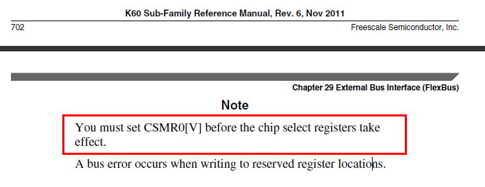

Hi Sudheer A,
I think maybe there is some misunderstanding between us, what I mean is FB_CSMR0[v] bit should be set even you have initialized FB_CSMR1[V] bit. so TWRK60_flexbus_init() for CS1 should be looked like the following:

Kan_Li
Seems you didn't initialize the bit of CSMR0[V] , please do it as well . You may refer to the following snapshots for more details about it.

Hi Kan Li,
I have set the  FB_CSMR0[v] bit before chip select, this code works fine for CS0. I am not able to set the CS1 to CS5 from start address 0x70000000 to 0x7FFFFFFF.

Tell me where am doing mistake.

void TWRK60_flexbus_init(void)
/* Enable the FlexBus                                               */
/* Configure the FlexBus Registers for 8-bit port size              */
/*  with separate address and data using chip select 0              */
/* These configurations are specific to communicating with          */
/*  the MRAM used in this example                                   */
/* For K60 tower module - do not set byte lane shift so that data   */
/*  comes out on AD[31:24]                                          */
  SIM_SCGC7 |= SIM_SCGC7_FLEXBUS_MASK;\
/* Enable CS signal */
  FB_CSMR0 |= FB_CSMR_V_MASK;
  //Set Base address
  FB_CSAR1 = (uint32)&MRAM_START_ADDRESS;
Hope that helps,
B.R
Kan
2,965件の閲覧回数
sudheera
Hi Kan Li,
Thanks for your support, now it's working fine.
Sudheer A.
