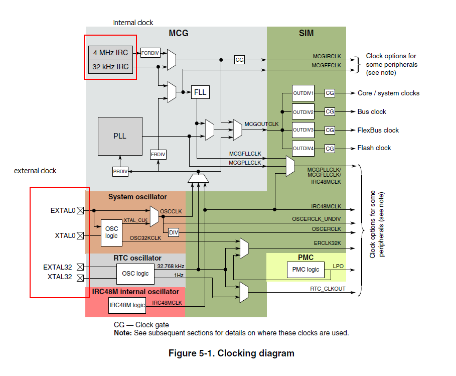

Hi Christian,
K22F not only can use internal clock, but also can use external clock.
And  through configuration related clock register to get the core clock 、bus clock and so no.
You can refer to here (it in the Reference manual  p156) :
And the detail you can refer to the "Chapter 5 Clock Distribution"

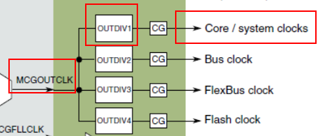

Hi Christian,
1)  Please see here :
the core clock is   MCGOUTCLK divided by OUTDIV1 clocks (the SIM_CLKCIV1 register).  (About the clock definitios please see the 5.4 Clock definitions of Reference Manual  ).
About the clock regiseter cofiguration , need configuration MCG and SIM.
2) Yes,( i have not configuration CLOCK use KSDK, i only check the SDK API RM  )
3) NO, EXTAL32 and XTAL32 only can use 32,768KHZ crystal.
  while the EXTAL0 pin can use a signal generator .

Just a follow up on this question.
I am trying to use the xTAL32 32 KHz signal as an experiment to run the MCU. Now I noticed on the documentation that the clock specified to run the ARM coretex-M4 core is named "Core clock".
After that, there is no mention of a "Core Clock".
Question 1) Is the "core clock" the same as the MCGOUTCLK? The Diagram you sent me seems to indicate this is true.
Question 2) The documentation only differentiates between output of FLL/PLLCS, Internal ref clk (I assume 4MHz/32KHz), and External. However, the picture you sent shows 2 external clocks, a "System Oscillator", an "RTC Oscillator", and an IRC48M internal(?) oscillator.
I am assuming that all I need is to add the following line of code?
CLOCK_HAL_SetClkSrcMode(MCG_BASE,kMcgClkSelExternal);
CLOCK_HAL_SetExternalRefSel0Mode(MCG_BASE,kMcgExternalRefClkSelOsc);
and this is enough to get the device to work on the EXTAL32 clock signal?
Question 3) Can I connect a signal generator to the EXTAL32 and leave XTAL32 floating instead of using a crystal?
