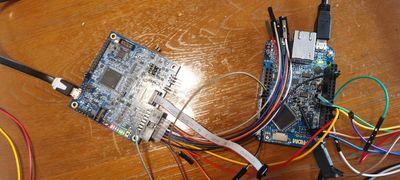

This project has been tested on FRDM-K64F.
 Hardware connection:
MCU-Link pro            FRDM-K64F
J19-2        ---       R75-1(flying a line is needed)
J19-3        ---       J1-8
J19-4        ---       J11-1
J19-5        ---       J1-12
   Connect ground together.
Operation steps:
Before power on, R75-1 should be connected to ground, then connect openSDA USB. Thus, K64 will enter EZport status.

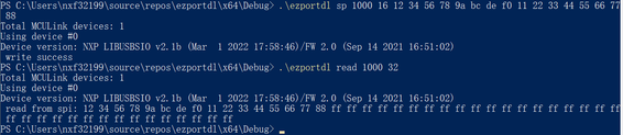

  1. Read memory
ezportdl read [address] [number]
  1. Write enable
ezportdl wren
  1. Write flash, which can write up to 1000 byte.
ezportdl sp [length] [data]
  1. Program a binary file into flash
Ezportdl dl [address] [file name] [flag]
address means start address flag=0 means erase flash before programming, flag=1 means don’t erase the flash.
