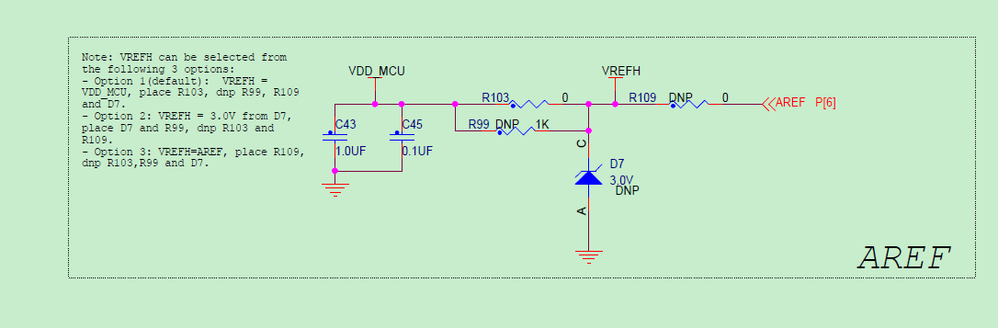

Hi, my name is Bence Kovari from Hungary. I have an FRDM-KEAZ128 board (80 LQFP package). Iam doing ADC, and i would like to use an External Voltage source as Analog Reference. The way i tried: I've checked my Header/Pinout, and connected my own voltage (in this case 1V) to AREF pin, and gnd to gnd (just one pin below AREF).  I coded the initialization structure, ADC_Init() etc (works fine so far). I add the line to the code to select  external VREF:
ADC_VrefSelect(ADC,0x01);
Then i read the channel ADC_CHANNEL_AD29_VREFH that should show my own external voltage,
but nothing happens. It's still 5V, the internal ref regardless. I've also tried:
ADC_SC2 |=ADC_SC2_REFSEL(0b01); (which i copied from an example source code).
I've checked the Reference manual that describes this topic quite shortly and messy a bit. Or i may have misunderstood something in the vref schematics or channel/pins description. So please if you could tell me how to do this stuff correctly i would really appreciate that!

kerryzhou
Hi Bence,
 From the FRDM-KEA128 schematic, you can get that if you want to use the external reference, you should choose options3.
Answer your question: How should i remove the resistors technically?
You should find an electric soldering iron, then remove R103, R99 and D7, short R109 in the FRDM-KEA128 board. It is the hardware operation.
Wish it helps you!
If you still have question, please let me know!
Kerry

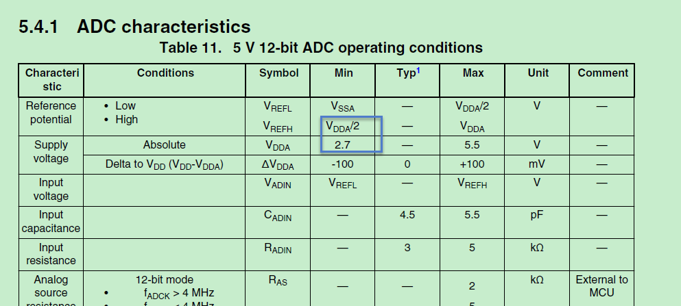

    I found you have some errors:
1. VREFH can't connect to 1V, because from the datasheet you can get that:
You can get that the Min data of VREFH is VDDA/2, you can't connect it to 1V.

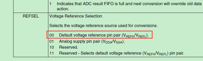

2.Select the reference pin pair as the voltage reference
You used this code:
But from the reference manual, you can get :
If you want to use the VREFH and VREFHL, you should choose REFSEL=00.

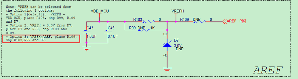

3. Take care the hardware
You can find the schematic of FRDM-KEA128 from this link:
http://cache.nxp.com/files/32bit/hardware_tools/schematics/FRDM-KEAZ128-SCH.zip?fpsp=1&WT_TYPE=Schem...
If you want to connect the VREFH to the voltage which you want, you should remove R103, R99, then connect VREFH to the voltage which you want, otherwise, VREFH is still connected to the VDD_MCU.

kerryzhou
Hi Bence,
Wish it helps you!
Kerry
