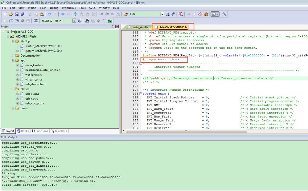

I am working with MK60N512MD100(TWR-K60N512 tower kit)
I tried to build the source code of USB-cdc mode in kiel V4 .But i am getting errors.
I have attached the error LOG file.

Hi KARTHIK A S,
  Please follow me do this modifications:
1. double click the error on your side, then add this code in the MK60n512vmd100.h:
#pragma anon_unions
2. Add CMSIS define in the options
project-> options for target
After the above modifications, save the project, and build it again, you will find the error have disappeared.
Wish it helps you!
If you still have question, please contact me!
Jingjing
