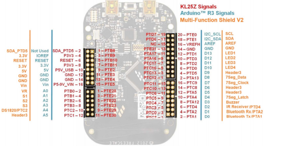

I need help in configuring the seven segment display on the multi function shield with the FRDM KL25Z board. I have soldered the pins of the shield to the FRDM board .

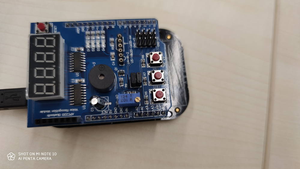

Thank you for your reply Kerry Zhou. As in the attached pic , I have mounted a ,multifunction shield on the FRDM KL25Z board . I need to configure the pins of the board with the sheild. I see that the PTA13 on board is connected to 7 segment display and the latch and clock pins . However , I do not know how to proceed. Any help will be appreciated.

Dear Kerry Zhou ,
The connections of the multifunction sheild pins to the FRDM KL25Z board is as in the first image. The seven segment LED is configures as image 2 in the sheild. Could you please help me integrate the two to display a number on the seven segement display?

kerryzhou
Hi Suma Rao
    From your picture 2, you need to know, the relationship with your LCHCLK, SFTCLK and the SDI.
    Take an example, when you want to display one word in the 4 Segment LCDs, the detailed wave it needed, then you can use the MCU to give the related wave.
    In you picture 2, you give the serial Data In data, it is 16 bit data, but you didn't give the related LCHCLK, LCHCLK, so you still need to check your own board related document, find which detail wave it needed, and the LCHCLK, LCHCLK bit rate. Then in the code, you even can use the GPIO associated with the timer to simulate the wave.
