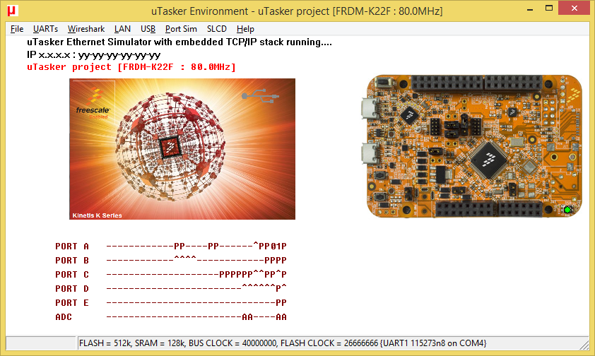

mjbcswitzerland
Specialist V
Some general MCG details:
http://www.utasker.com/kinetis/MCG.html
If you use the 10MHz clock input on EXTAL you can use it as PLL reference to generate (for example) 80MHz system clock:
- configure for oscillator instead of crystal
- divide the 10MHz by 4 to 2.5MHz reference
- multiple by 32 for 80MHz
I don't know how it is done in KSDK but in the uTasker environment it is controlled by:
#define EXTERNAL_CLOCK 10000000 // 10MHz external oscillator (not crystal)
#define CLOCK_DIV 4 // input must be divided to 2MHz..4MHz range (/1 to /24)
#define CLOCK_MUL 32 // the PLL multiplication factor to achieve operating frequency of 80MHz (x24 to x55 possible)
