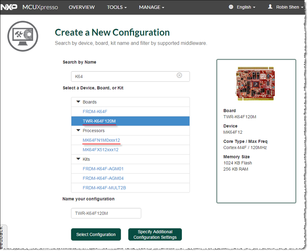

Setting up CAN communication on FRDM-K64F eval board?
I am using SN65HVD230 CAN Board as a transceiver for CAN lines.
Using Loopback example code as a starting point.

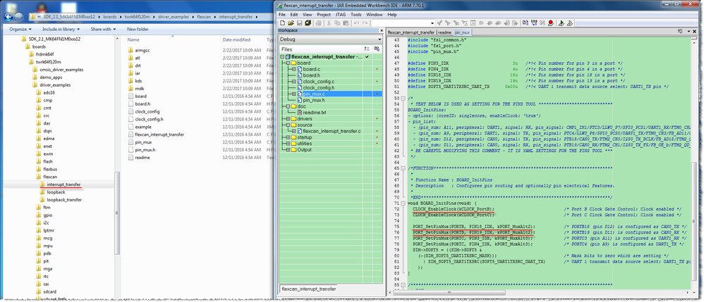

Have you try to configure these pins as CAN function? These pins are disabled by default.
You can refer the flexcan interrupt_transfer example in SDK_2.1_MK64FN1M0xxx12.
The Flexcan Interrupt Transfer example is in twrk64f120m folder.(You need to download SDK_2.1_MK64FN1M0xxx12 or SDK_2.1_TWR-K64F120M. Don't select FRDM-K64F. )
