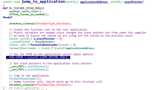

Hi @andrewparlane :
Thanks for your feedback.  We have a MCU-BOOT middleware, VTOR is configured there.
SDK_2.9.0_FRDM-K66F\middleware\mcu-boot\src\bootloader\src\bl_main.c

andrewparlane
That doesn't help if the application is run out of RAM, and in a couple of other possible albeit weird setups
This is either a bug or the comment needs to be re-written to state that setting the VTOR and stack pointer for applications that don't have their vector table at 0x00000000 is the job of the bootloader / JTAG programmer.
I'd suggest setting the VTOR register in the CMSIS SystemInit() function as the comment suggests, since it's an easy fix, and has no downsides. The stack pointer is more complicated because we'll have already used the stack by the time we get to that point, since the entry point is a C function. This means if you execute from RAM and the flash is erased (or at least at the first word is 0xFFFFFFFF) then the application will immediately crash, since the first assembly instruction is to write data to the stack with will be an invalid address.
