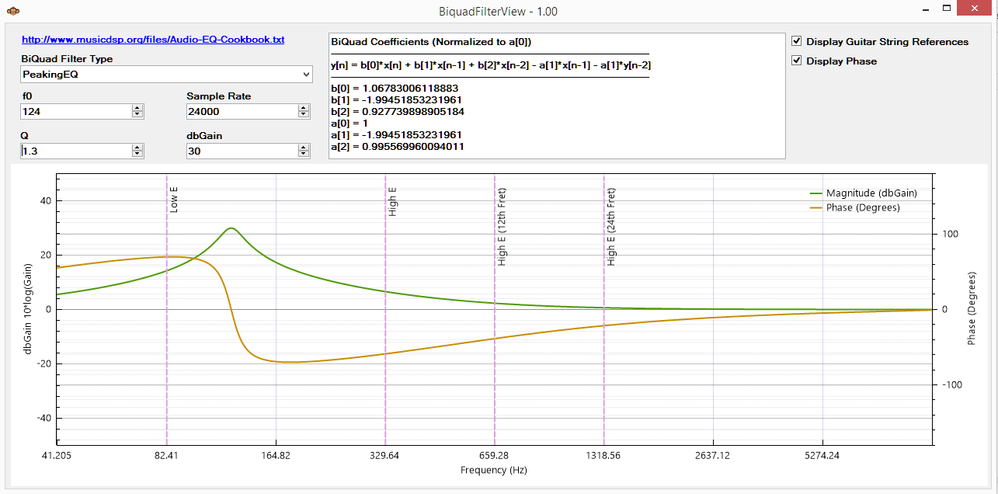

Summary:
This tool is based upon the Audio BiQuad Cookbook Here:
http://www.musicdsp.org/files/Audio-EQ-Cookbook.txt
Very useful for configuring the FRDM-JAM and the MonkeyJam software!

I am trying to implement CMSIS - Biquad Cascade IIR Filters Using Direct Form I Structure in my code and I am trying to calculate the coefficients using your tool. In the "http://www.musicdsp.org/files/Audio-EQ-Cookbook.txt" file, the equation is as follows:
y[n] = (b0/a0)*x[n] + (b1/a0)*x[n-1] + (b2/a0)*x[n-2] - (a1/a0)*y[n-1] - (a2/a0)*y[n-2]
However, in the BiQuadFilterView program of yours, in the info area, I can see that the equation is as follows:
y[n] = b[0]*x[n] + b[1]*x[n-1] + b[2]*x[n-2] - a[1]*x[n-1] - a[1]*y[n-2]
In the Keil CMSIS documentation, the equation is as follows:
y[n] = b0 * x[n] + b1 * x[n-1] + b2 * x[n-2] + a1 * y[n-1] + a2 * y[n-2]
Notice the difference in between -a[1]*x[n-1] - a[1]*y[n-2] and + a1 * y[n-1] + a2 * y[n-2].
Is this a typo or the BiQuadFilterView uses a different algorithm?
Hello Abdullah.
Sorry for the confusion.    Here are some pointers.
1.)
Equations 1 and 2 are really the same equation.    my b[0] is just b[0]/a[0] in the 1st equation.    I keep the coefficients normalized to the a0 coefficient from the start.
You can get the source of the program here:
ehughes/BiquadFilterView · GitHub
the file eDSP.cs has a function called "DesignBiquad" that shows how I get from one to the other.
2.)   Good observation on the keil implementation.   If you go through their documentation
http://www.keil.com/pack/doc/CMSIS/DSP/html/group___biquad_cascade_d_f1__32x64.html
They mention that they use a different sign convention for a1 and a2.   If you use BiQuadFilterView,  you will need to flip the sign.
3.)    Check out this project:
Freescale Hack It Together (H.I.T.) Project Initiative - Get Excited!
I didn't use the CMSIS implementation as it is optimized for block processing and I wanted per sample processing.   You can find an IIR implementation that implements some functions that compute fixed point coefficients for the biquad in C.
