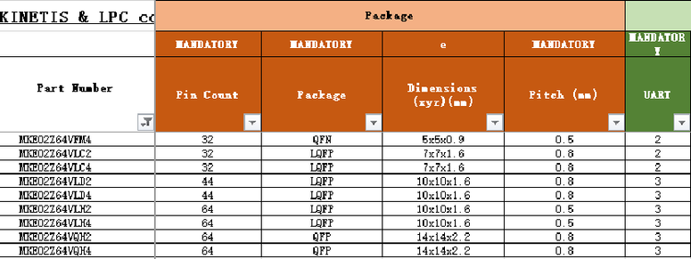

I've got a FRDM-KE02Z board, but I can only find FRDM-KE02Z40M board in NXP website.
Also I can only find KE02Z64xxx4 (no KE02Z64xxx2) SDK support in MCUXpresso IDE 11.2.
So anyone could tell me the main differences between these two MCU except MAX CPU frequency?
CAN I use KE02Z64xxx4 SDK to programm KE02Z64xxx2?
Thanks.

Apart from respecting the maximum frequency the same code can be run on the FRDM-KE02Z and the FRDM-KE02Z40M.

Except for the CPU frequency, please refer to below differences.
