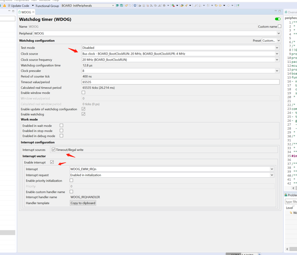

1.Run configure tools,and then configure watch dog as follows.
It choose bus clock in PEE mode. And it opened interrupt .

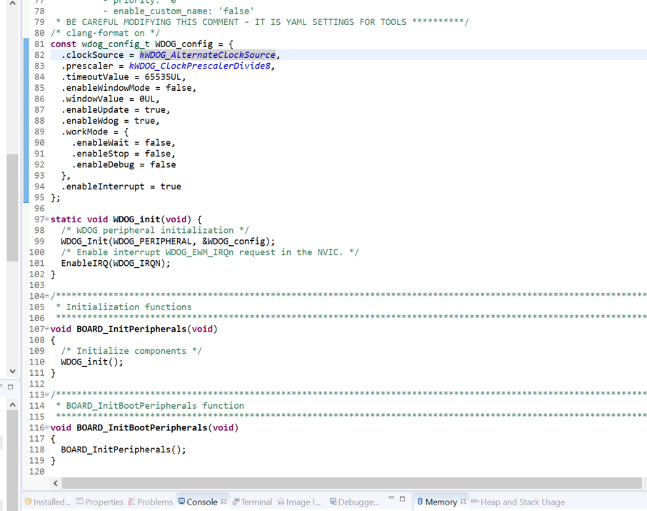

2.Here we can see the details about watch dog configuration.

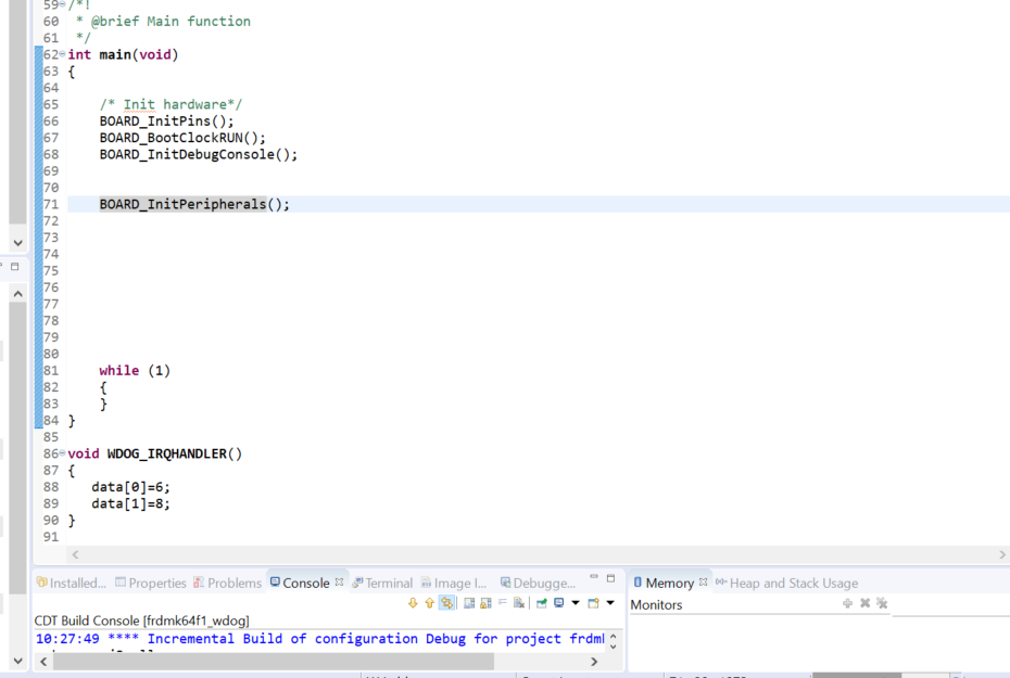

3.We set a variable to check if it run to handle and if it reset.

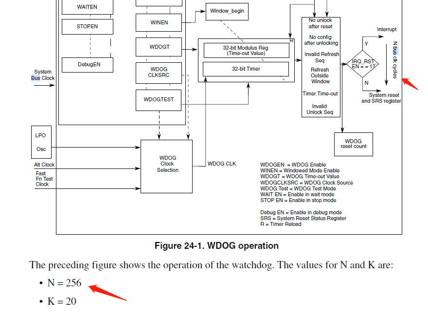

Why we set a variable but not do some other operations? See the follow picture.
Before interrupt handle and system reset , it only has 256 bus clk cycles.

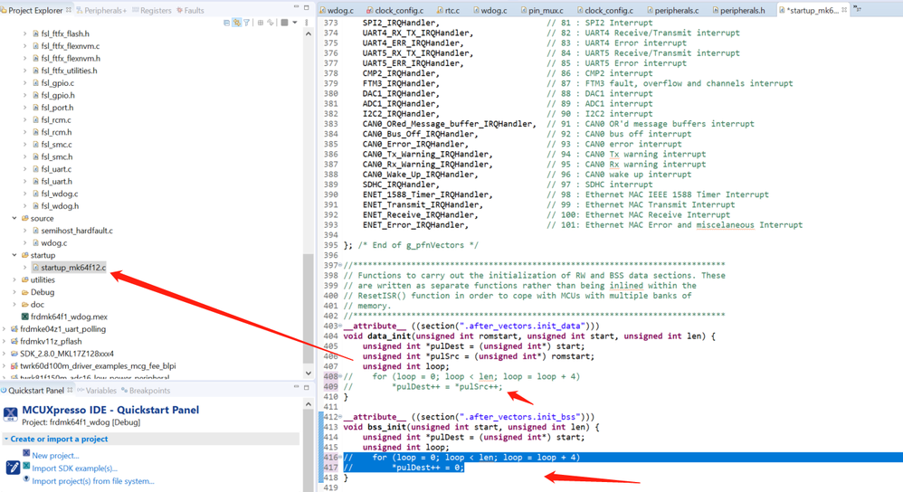

3.png3.png4.Comment these functions because it will initial data and bss segment after reset,that means you will not see the change of the variable  .

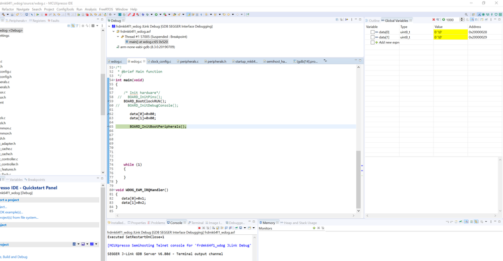

5.Add break points as follows.
