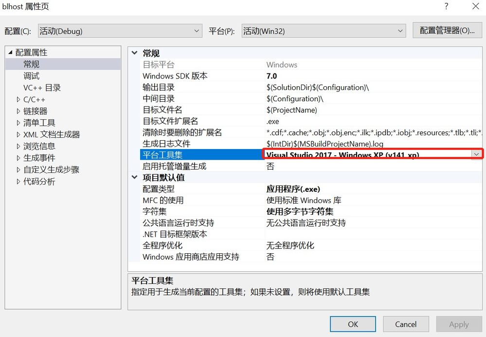

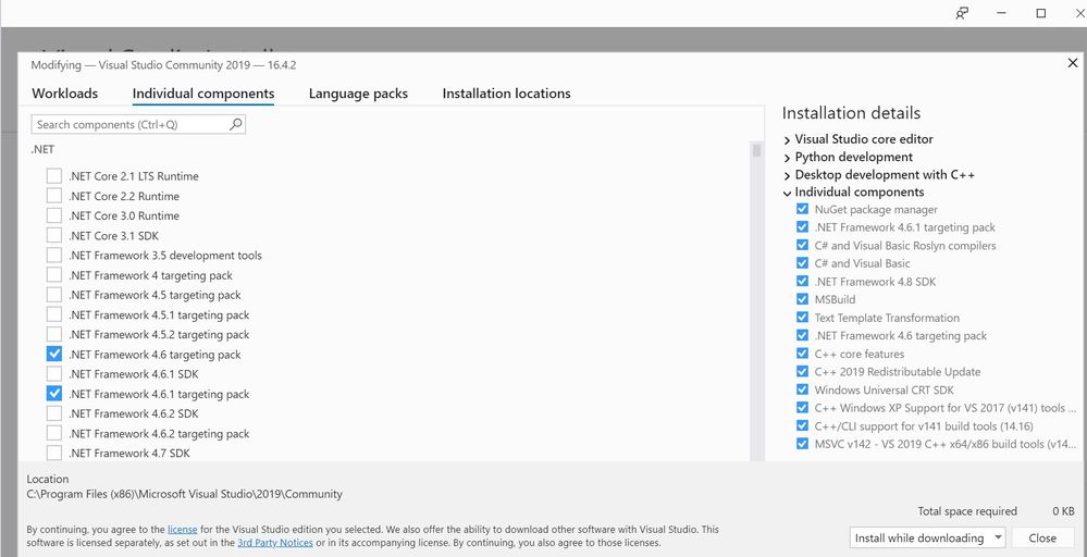

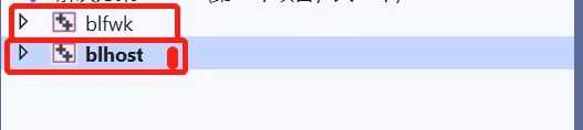

Here has some issues when compiling blhost which make it hard to connect to the bootloader.
Here is the solution.
Open tools menu,and select the options in the red box.
If you operate follow above steps,Blhost could be compiled success .
