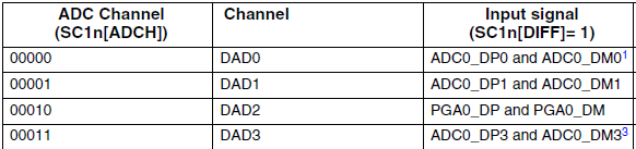

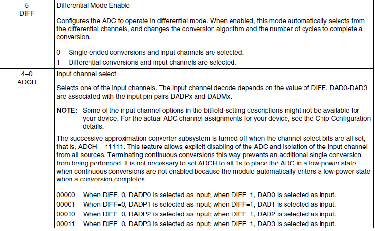

You can select the inputs channel for the ADC with the Status and Control Registers 1 (SC1). Over there you also have to specify the operation mode (Differential or single-ended).
In ADC0, the channel DAD0 is:
The inputs that you mentioned (PGA0DP_ADC0DP0_ADC1DP3 and PGA0DM_ADC0DM0_ADC1DM3) can be used for ADC0 or ADC1, so please consider it.
I made this quick code for a ADC0 initialization:
void ADC0_init(void)
       /* Clock ADC0 */
        SIM_SCGC6 |= SIM_SCGC6_ADC0_MASK;
        /* Configure for Differential mode and select DAD0 (ADC0DP0/ADC0DM0)
          * default value for ADCH is DAD0*/
        ADC0_SC1A = ADC_SC1_DIFF_MASK;
        /* Select 16-bit conversion and low porwer enable
         *  divider 8 from the input clock to ADC16 and long sample resolution */
        ADC0_CFG1 = ADC_CFG1_MODE(0x03) | ADC_CFG1_ADLPC_MASK | ADC_CFG1_ADIV(0x03) | ADC_CFG1_ADLSMP_MASK;
        /* Asynchronous clock output enable */
        ADC0_CFG1 |= ADC_CFG1_ADICLK(0x03);
        ADC0_CFG2 =  ADC_CFG2_ADACKEN_MASK;
