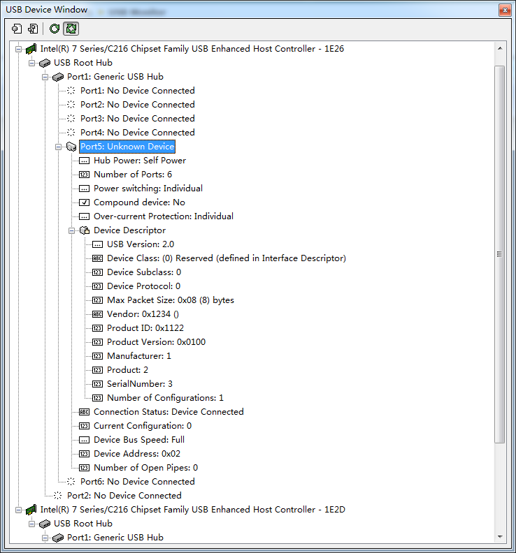

I am sure the previous three steps are successful, because the USB device can be showed by a tool named as 'USB Monitor'. following is the cut picture.
Port5 is my PCB, there Vendor=0x1234, Product ID=0x1122 are correct.
My question is:
Why the host quits instead to continue to request CONFIGURATION DESCRIPTOR
What is the problem, I have tried one week to search the BUG, and have to give up today, and need your help now.

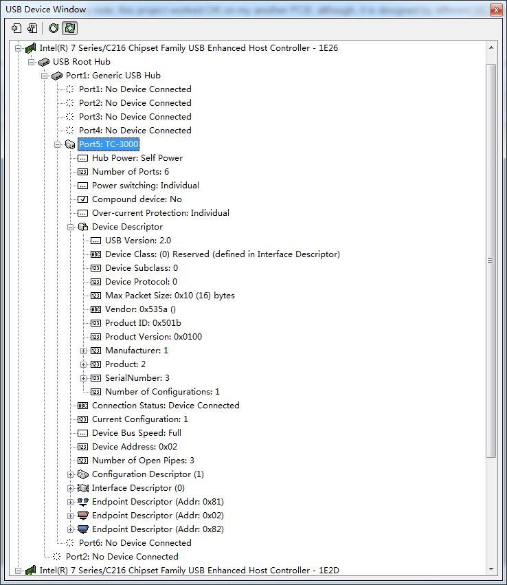

Please note, this <drive_usb.c> worked OK on my another PCB, although, it is designed by different MCU, MKL26Z128VLH4.  It can be correctly detected as following also by USB Monitor

Answer by myself.
Today, eventually, I have found the bug.
I suppose the reason is the USB Engine can't read FLASH ROM.
As it happens, the variable "ConfigDescriptor" is located in FLASH ROM, however the "DeviceDescriptor" is located in RAM, look at following codes:
static LDD_USB_TDevDescriptor DeviceDescriptor = {.....};
static const unsigned char ConfigDescriptor[] = {........}; // note the "const" keyword
At 1st step, GET_DESCRIPTION (type=DEVICE), it is correct.
but when GET_DESCRIPTOR (type = CONFIGURATION), MCU cannot read correctly ConfigDescriptor from FLASH ROM.
As soon as the "const" is deleted, the USB device is enumerated successfully!
ps. this problem occurs only for CortexM4F platform, But Cortex M0+ has not this shortcom. Hence my another board based on MKL26Z128, whose USB code is the same, is normally running.
That's all.
