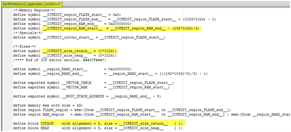

I just checked the linker file of led_demo_k64f12,  application stack is defined inside range 0x1FFF0000- 0x20000000
However if you create a new k64 project in KDS, the default stack allocation is in m_data_2 from 0x20000000. See linker file *.ld.
m_data_2 (RW)  : ORIGIN = 0x20000000, LENGTH = 0x00030000
so you need modify the default ld file to allocate stack inside range 0x1FFF0000- 0x20000000

As you told,I have looked in .icf file of led demo app for frdm k22f board and seems it may not cause the problem.
