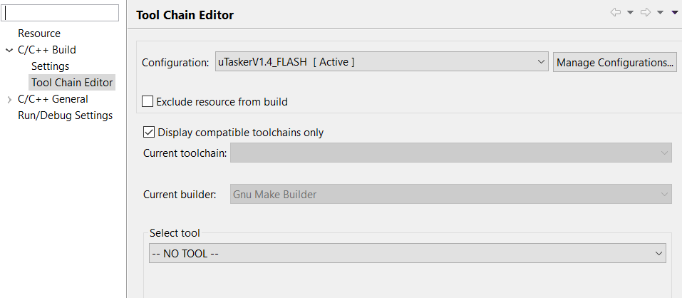

I have an assembler file in a project - say "myFile.s" - but KDS will not assemble it.
Looking at the properties of the file in KDS I get this in the Tool Chain Editor:
And it won't let anything else be selected as tool.
So I rename the file - to say "myFile.asm" - and now it recognises it and assembles it.
This means that I need to rename all *.s files to *.asm files to be able to build, but I am sure that this can't be true because often assembler files are names *.s.
How can I therefore tell KDS that it should recognise the *.s files ???

unfortunately, this is an old CDT odd thing. I recommend to rename the *.s to *.S.
See Assembly Files in Eclipse CDT Projects | MCU on Eclipse  for information about this and how you can have *.s (lower case) recognized by the GNU assembler.
I hope this helps,
Erich

Adding the *.S file type to each KDS project seems too complicated (I would need a guide for every new project so that the setting doesn't get lost - I already need a guide because some settings always get lost when transferring projects and don't want to make this even longer....).
Therefore I renamed all *.s to *.S.
I notice that all GCC startup files in the KSDK are *.S (those for other compilers are *.s) and also assembler files in CMSIS are *.S. Presumably due to this problem.
In KSDK the mmCAU assember files are *.s and so get ignored by KDS. Possibly the librarian does accept *.s since they are usually built to a library before use(?)
