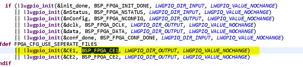

Hi everyone,
I am having a weird issue.
Something is not getting copied correctly when i rebuild my bsp/psp libraries.
I am doing a build for a custom board using MQX 4.2.
I made changes to the header file that has my pin definitions in it (XXX_k60n512.h).
I did a clean build of the bsp library where i thought it would copy over the file to the '\lib\debug' folder upon completion.
In ther KDS i right-click on one of the definitions i added....
and i get this error....
I do not get any compile errors for not finding BSP_FPGA_CE1. (I assume i would?).

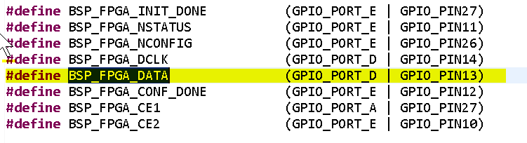

Next odd occurrence...
I tried to Open the declaration of the another define....
and it took me to a different define?
How can i fix this problem?
-Jason

jasonscott
Solved!
Under the KDS application.
Go to Project-> c/c++ Index -> Freshen All Files.
-Jason
