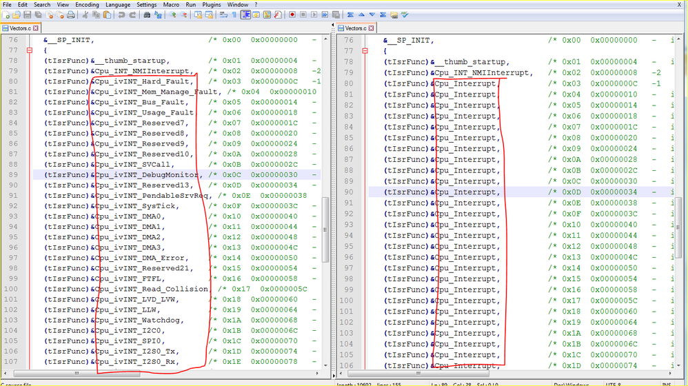

I have a question regarding the interrupt vector table generation  (vectors.c) using processor expert.  The code I inherited from my former college is shown on the left below.   I was trying re-generate a new project using KDS 3.2.0, and the generated code (vectors.c) is quite bit different as shown on the right side of the figure below.  Are there any disabled settings I am not aware of?   Does the KDS version (3.2.0 vs 3.1.0) make any difference?   Thank you.

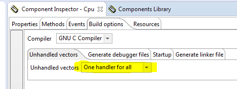

Hi Daniel,
try this option in CPU component:

danielcheng
Thank you.  this works out for me.

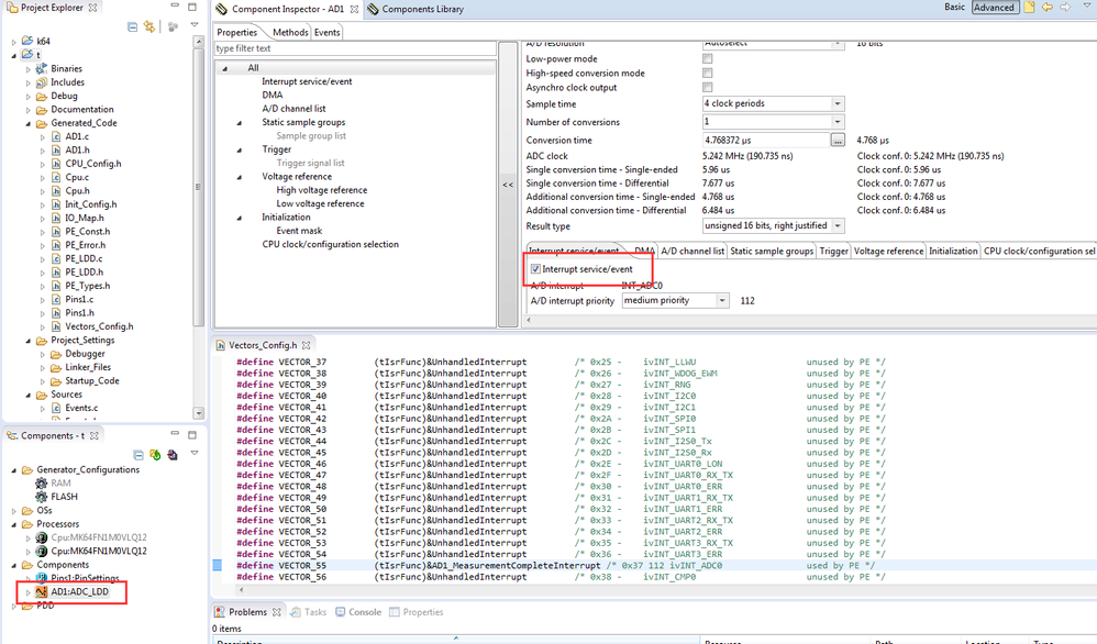

Hello Daneil,
There is no wrong about your code , these are different version.
On KDSv3.2 , it will show the interrupt function name after you enable the related interrupt
on component . For example , if you use ADC interrupt , after you enable the interrupt at here :
then click generate code , build , in the Vectors_Config.h file , you can see the ADC interrupt function .
