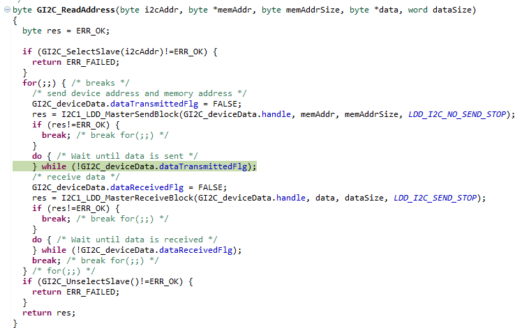

The code hangs intermittently at the line highlighted below. I can duplicate the problem in various conditions.
The difficult part:  It works a lot of the time.

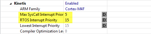

Another common problem is not having set the correct interrupt levels for the RTOS. See RTOS for ARM Cortex-M
Your Systick (and therefore the RTOS) shall run with the lowest priority. This should be 15 (see below):
So if you are calling any RTOS functions from the I2C interrupt hooks (e.g. from OnMasterBlockSent() hook), you need to make sure that the interrupt priority of the I2C interrupt is numerically *higher* than MaxSysCall interrupt priority, as the RTOS is masking/disabling all the interrupts from that number and higher (Note: on ARM the higher the number, the lower the priority/urgency!). Failure to use interrupts properly results in sporadic errors as in your case.

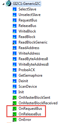

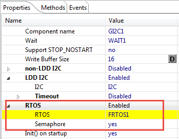

Next, the question is if you are using the I2C from multiple tasks? If so, you have to protect access to the bus with a mutex. The GenericI2C component has a setting for this:
If you would like to do your own mutual exclusion, you could enable the two hooks below:

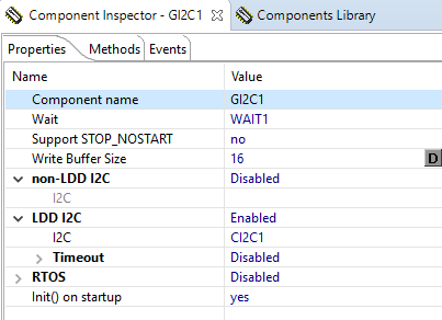

Thanks for your reply.  I have been poking at this on and off for the last few days.  Some of the information I started with is not correct.   I have identified the situation when it hangs - no ACK from the device, either from not a valid address or not accessing valid register within the part (oops and oops).

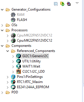

I started over with a new PE project looking like this:
All works properly except when no ACK.  In this case CI2C1_OnMasterBlockSent() never gets call and therefor never sets the  dataTransmittedFlg flag.
The simplest operation like  res = GI2C1_ScanDevice(0x__); still hangs here:
do { /* Wait until data is sent */
    } while (!GI2C1_deviceData.dataTransmittedFlg);

It's even simpler than you described (I think).  It hangs every time if it does not receive an ACK.   If I remove all devices from the bus (pullups still connected) and call GI2C1_ScanDevice(...) it hangs.
Maybe that is the expected behavior for the I2C component but I thought the GI2C1_deviceData.dataTransmittedFlg flag would be set even if no ACK was received.  The PE_ISR(CI2C1_Interrupt) is triggered even when no ACK is received and the I2C status register TransferComplete flag is set.
Adding the timeout does resolve the problem but I expected the GI2C1_WriteAddress(...) function to return with an error rather than just hang.
Have I missed something or does the PE component not support this?
