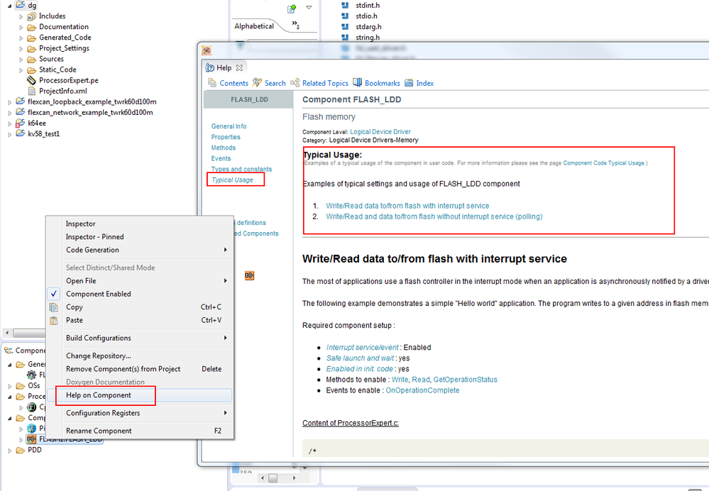

Hello VIGNESH,
Do you use the KDS IDE ? If yes, you can create one Processor Expert project,
then add the ""FALSH_LDD" component,  right click the "Help on component " , in the typical Usage , there is the demo code
about flash .
Hope it helps
