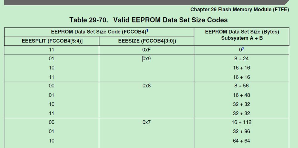

   As you know, the useful data to the EEPROM data set size code is just 6 bits, like the following picture:

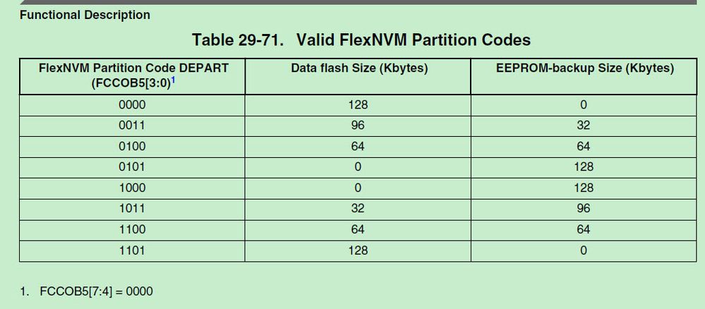

The useful data to the FLexNVM Partition code DEPART is just 4 bits, like the following picture:
then you get EEPROM data set size in address 0x8003fd is 0xF4 , what you expect is 0x34
0xF4 = 0b 11110100
0x34 = 0b 00110100
You can find the 6 useful bits are the same, you just need to check these 6bits in EEPROM data set size, not all the byte.
You get FlexNVM partition code in address 0x8003fc is 0xF5 , what you expect is 0x05
0XF5 = 0b11110101
0x05 = 0b00000101
You still can find the 4 useful bits are the same, you just need to check these 4bits in FlexNVM partition code, not all the byte.
2. Refer to point1. Your data is correct to the useful bits.
