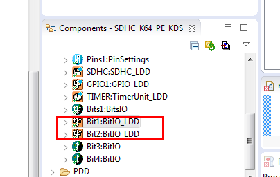

I'd like to know whether I could create data bus using BitsIO but pins will be from different port. I am trying to port my mbed program to KDS.
I'd like to create data bus as in the following code.
dataBus( PTA13, PTD5, PTD4, PTA12, PTA4, PTA5, PTC8, PTC9 );

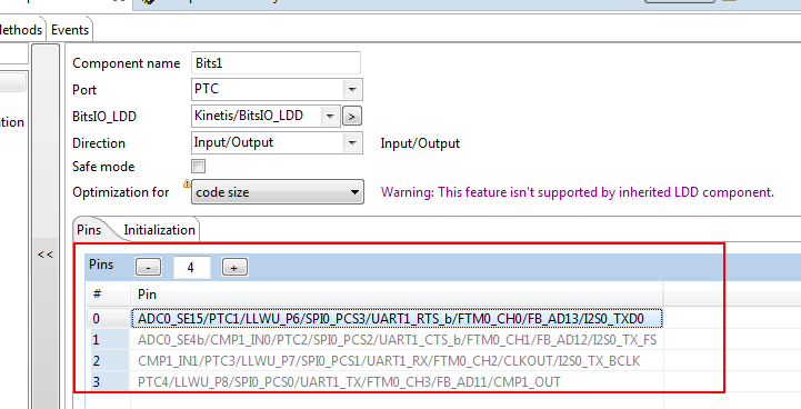

BitsIO component is only for one port, for example portA. if your dataBus contains other port, for example PortC, we can't implement the data bus with one BitsIO component. we need use additional BitsIO component for it. or use BitIO for one pin of each.
then you make your own dataBus function to combine those different together.
does this answer your question?

Hello Bryan,
The component of "BitsIO" only can use the continual ports :
And does add some BitIO_LDD components  can meet your requirement ? then configure different ports .
Hope it helps
