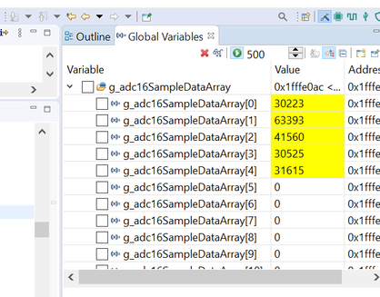

Problem Statement: K32L2B ADCs don't have the capability to scan through all the connected channels in one conversion. The input channels are muxed into the ADC, So you need to set the ADCx_Rn register to the channel number you want to convert, Run the conversion, read the results and then Set the other ADCx_Rn in that ADC to the next channel to be converted. The next conversion can then  be triggered. You have to tell each conversion the input channel it is to convert. Everytime setting a new channel and reading previous channel data can consume much CPU core bandwidth.
The goal of this example is to read all ADC inputs of Kinetis K32L2B in a row without the need of using CPU core for switching channels  and reading individual result values.
Project Description
The DMA in this example is used for controlling all the channel switching, reading the results for series of measurement into a memory buffer.
The Direct Memory Access (DMA) channels are configured for writing and reading ADC registers the following way:
  • DMA channel 0 reads converted results (ADC0_RA register) and stores them in g_adc16SampleDataArray[ ].
  • DMA channel 1 selects the ADC channel and starts conversion (ADC0_SC1A register) using values from memory g_adc16ChannelDataArray[ ]
The data for the DMA channel 1 is prepared in the g_adc16ChannelDataArray prepared in memory and the DMA operates in the following cycle:
Step 1 In the beginning, the DMA channel 1 transfer is started using software trigger. This configures the channel and starts the conversion.
Step 2 After the conversion is complete, the result is read by DMA channel 0 and stored to results array. Channel linking executes the Channel 1 transfer and the cycle continues.
 After all needed channels are measured (DMA byte counter reaches 0), the DMA Interrupt is invoked so the user code is notified.
See the following figure describing the process:

4. Running the Demo
  • Import the attached project into MCUXpresso v11.2, SDK v2.8.0 K32L2B
  • Build the project
  • Connect FRDM K32L2B board with PC
  • Debug and Run the application
  • Watch ADC result in g_adc16SampleDataArray[n] in Global variables window for the channels SC1A  data given in g_adc16ChannelDataArray[n] respectively
Attached is the Project for reference.
