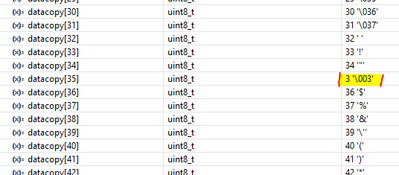

Result:
At first I was increasing my flash location pointer by 100 (using FlashBufferHead ) during each run to allow a multiple of 100 bytes per pages to be saved. The second run I notice an offset in the values read. The values written are there, but seem to start 4 bytes later. I expected to be able to write at least in multiples of 4 bytes.
(...sorry my mcuxpresso is really buggy now... no screenshot yet...)
If I'm increasing pointer to flash by 256. The second run byte 35 is always read back as a different value then was requested to write. All other 100 bytes are written\read correctly.
If I'm increasing my flash location pointer by 512, this always results in a FLASH_ErasePages call before each write. Then there are no issues.
