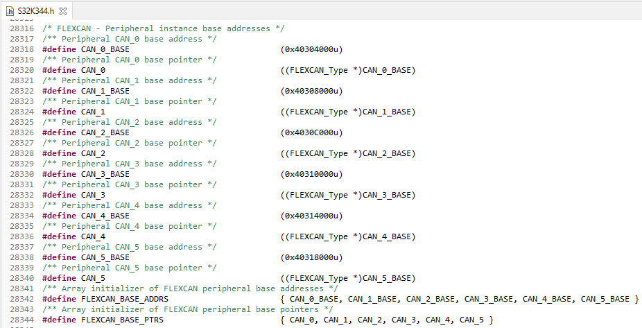

I am getting stuck on step 3. Specifically, setting the CAN base address. While configuring the CAN module in Design Studio, I did not see any field for base address but I did come across CanHwFilter in which an address can be set. Is this the one to be used?
Further, I tried calling the FMSTR_Init() function from the main c code generated for my model, and I can see that the freemaster.h header exists in the model's main header file, but I get an error saying undefined reference to FMSTR_Init.
Can you please help with this?
10,911件の閲覧回数
iulian_stan
Hi @rishikesh_c,
1. Regarding CAN base address - it is defined in S32K344.h header file.

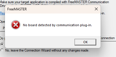

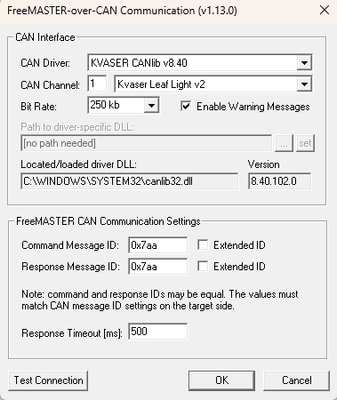

Thanks for the quick response. Setting the TSA variable to 0 worked and I was also now able to build my simulink model successfully. The next problem I am facing is over FreeMaster itself. In the connection wizard I selected the "Connect over CAN bus" option and after that, in the plug-in configuration options, I set the Driver and baud rate based on my model and the CAN device I am using to connect to my PC.
However, clicking on Test Connection, I get an error saying "No board detected". I think the issue is with the Command Message ID (it is set to the default value in FreeMaster and I am not sure which is the correct one). How do I fix this error and how do I find the Command Message ID if it is in fact the cause of the problem?
10,875件の閲覧回数
iulian_stan
0x7aa is the default Command ID used by both FreeMASTER library and desktop tool, so you don't have to change it.
