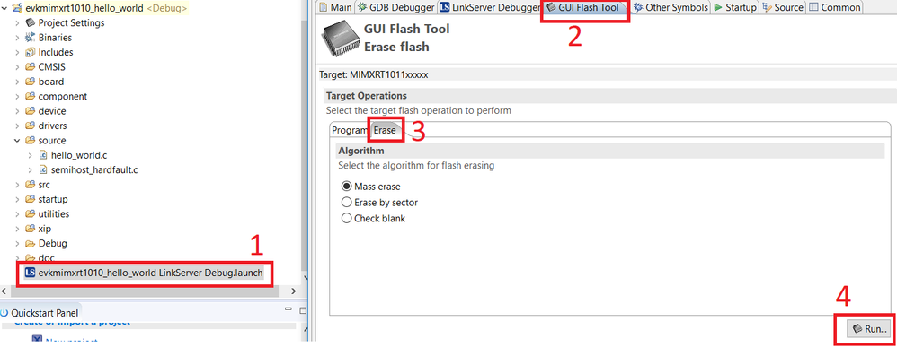

I was using the EVK, nothing fancy and suddenly I cannot connect more using the DAP interface. I have tried to connect using my J-Link Plus and same thing. Here is the output log of J-Link

Does someone know the possible root cause of this?

It may that your code is causing it to go into a reset loop. Try setting it to Serial Downloader mode (dip SW8 to 0001), erasing the flash (or even just downloading an application you know works like the hello world demo), and then setting back to internal boot (dip sw8 0010).
Erasing flash using MCUXpresso:
-Alex
