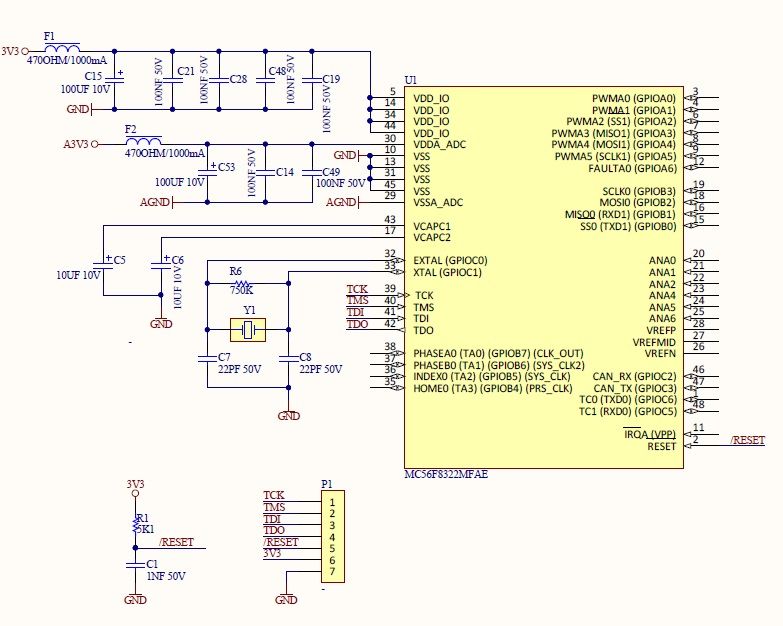

alikozan
Hello again
Thank you for your reply, but I'm sorry that I'm not permitted to send the full schematic of the board. Instead, I'm sending a clipped schematic below, consisting of JTAG and uC's power and clock input circuitry. I hope it will be sufficient for you.
Anyway, I'd like to remind that, I can debug the bootloader executable on the crashing card, however I can not debug the application executable. I don't run the debug session on "Attach to Process" mode, since it is not supported by my USB TAP.
Ali
3,253 Views
johnlwinters
Hi.
Please refer to the data sheet for the reccommended pull ups or pull  downs for the JTAG signals.
Without these, debugging or even execution without the debugger attached, can be sporatic.
