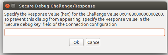

When I tried to re-flash the bootloader USB Tap is not getting connected.
For your information:
I am using P1010 custom board, by default it boot from NOR flash. I am getting U-boot log but get hang when it start to configure DDR. In our board we use fixed ram rather than SPD.
That mean, I have not yet configured the DDR completely.
When I tried to reflash the corrected code my USB tap is not getting connected and it is throwing error. let me know how to configure CodeWarrior IDE.

“Secure debug violation” is a generic error and this can means a lot of possible errors (DDR initialization failed, corrupt core, invalid JTAG/config_chain and so on) – this way because there is only one error signal/pin and the ccs can’t multiplex all types of hardware errors using it.
If you don't want to init the DDR in initialization file, you have to init at least SRAM and NOR flash, to be able to reprogram your board.

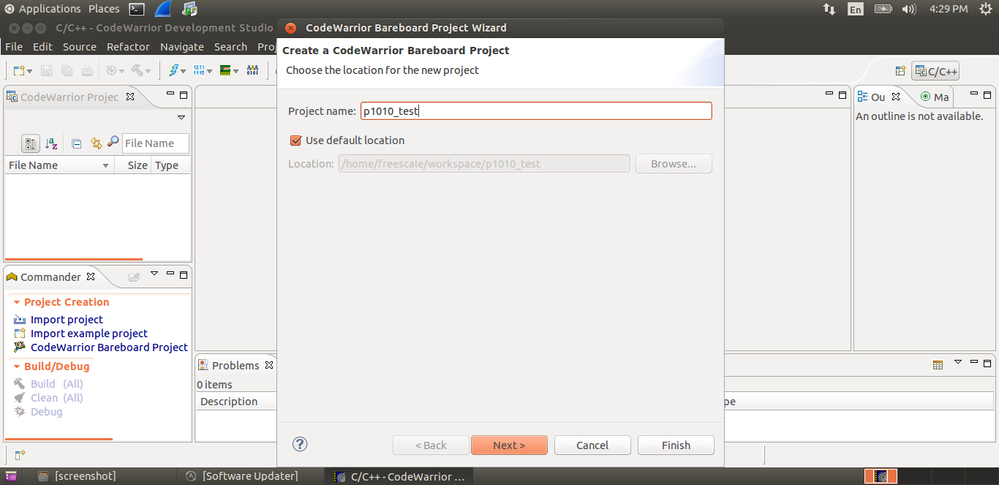

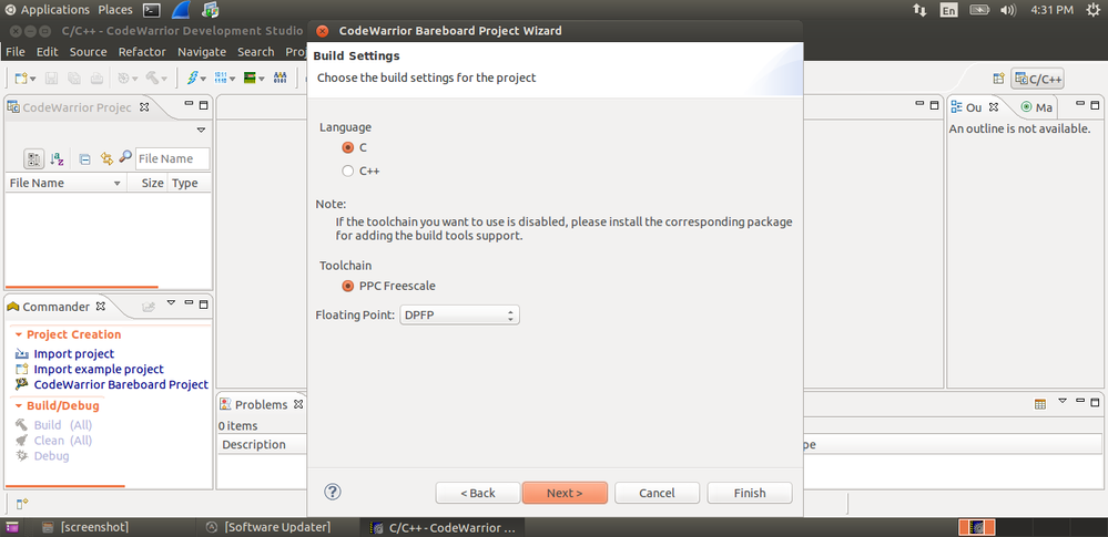

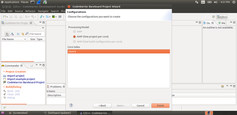

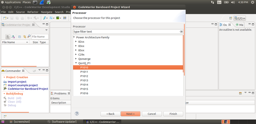

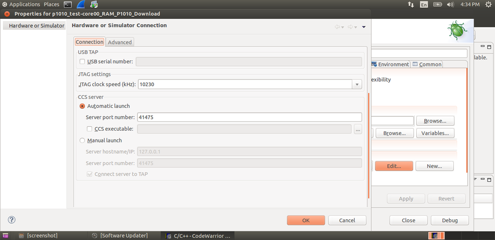

nobelsharanyanj
hi Adrian,

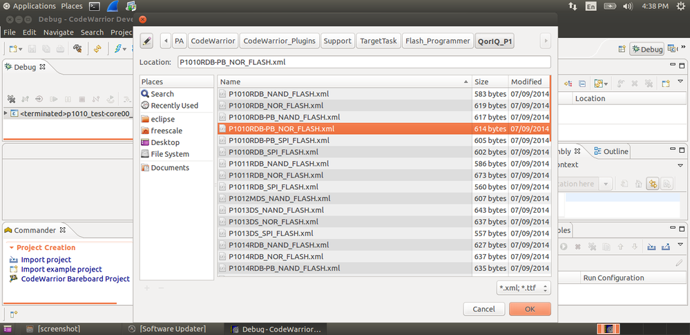

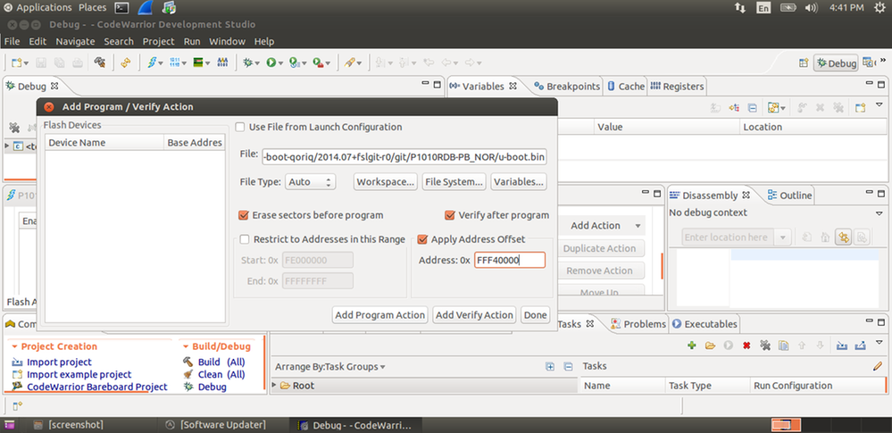

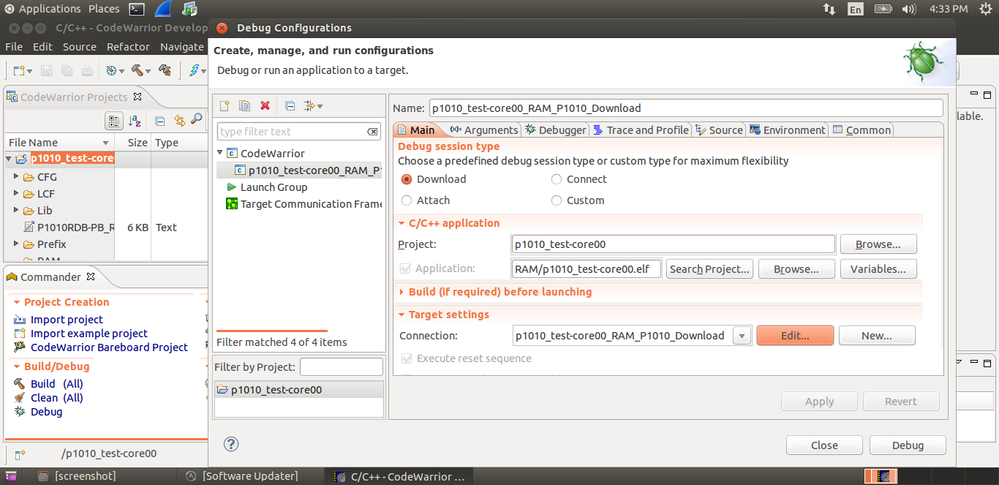

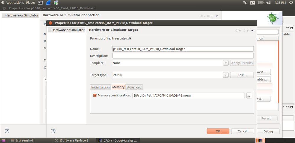

please find the steps I follow,
003.png004.png005.png006.png007.png008.png009.png010.png011.png012.png013.png014.png015.png
after that I configure RUN, and execute button got enable and I tried runing the application but getting the same problem as mentioned in the code.
Let me know the steps I followed is right?
