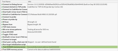

We have a customized LS1043a board, being having problem debug "Hello world" project on it with CodeWarrior (connected via CW Tap). To narrow out the incorrect DDR initialization possibility, I modified LCF (  aarch64elf.x) to make the code to be downloaded to OCRAM to run(following NXP Document AN5346.pdf), but it still complains "target memory fault.....".
I wonder there is something there to stop the elf to be debugged by CodeWarrior, doesn't matter where the elf is downloaded. Have being hanging here for a week, Please, anyone have any suggestion will be deeply appreciated.
Here is my GDB traces (with errors in red font):

323,517 &"target memory fault, section .vectors, range 0x10000000 -- 0x10000888\n"
323,518 23^error,msg="target memory fault, section .vectors, range 0x10000000 -- 0x10000888"

323,594 &"Warning:\n"
323,594 &"Cannot insert breakpoint 1.\n"
323,594 &"Cannot access memory at address 0x10000d28\n"
323,594 &"Cannot insert breakpoint 2.\n"
323,594 &"Cannot access memory at address 0x10000d2c\n"
323,594 &"\n"
323,594 34^error,msg="Command aborted."

Please refer to "9.2 Connection diagnostics" section in C:\Freescale\CW4NET_v2020.06\CW_ARMv8\ARMv8\Help\PDF\ARMv8_Targeting_Manual.pdf to perform diagnostics task on your custom board.
In this diagnostics task, "Test OCRAM memory access" action is performed.
2,867 Views
Tao2022
Hi, Yiping, thanks for replying my post. I went through the connection diagnose, it shows  "Test OCRAM memory access" successfully tested address 0x10000000.
