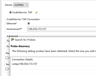

I installer win10 in virtualbox, and install CW DS in virtual PC, but CW can not scan ip rightly in virtual pc, please tell me where is wrong or how to configure? thanks very much.
on outside pc,  the cwtap usb ethernet ip use static ip,192.168.11.50
in virtual PC, the NIC is used bridge mode,and static ip is 192.168.11.10
but last in CW DS, the scan ip is  169.254.173.157, it sames the DHCP server, and can not telnet.
Best Regards
Qiuju.ye

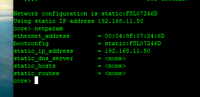

In the console of CodeWarrior TAP, please type the following commands.
core> netparam static_ip_address 192.168.11.50
core> netparam bootconfig static:lab01
core> reset

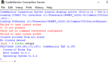

In the console of CCS, please try the following commands.
% delete all
% config cc cwtap:192.168.11.50
% show cc
In addition, CodeWarrior Connection Server failed to open listen socket, it means CodeWarrior IDE cannot work normally.

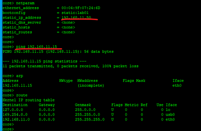

otherside, outside PC and virtual PC can ping well via cmd, but in CW TAP console, can not ping virtual PC well.

yipingwang
It is abnormal that the HWaddress is "incomplete" in the arp table of your CodeWarrior TAP.
Please restart your CodeWarrior TAP.
In your virtual PC, please add the following arp table(MAC address of CodeWarrior TAP).
arp -s 192.168.11.50 00-04-9f-07-24-6d
Then in your virtual PC, ping CodeWarrior TAP IP 192.168.11.50.
In CodeWarrior TAP console, check whether arp table is valid(display the mac address of your PC).
