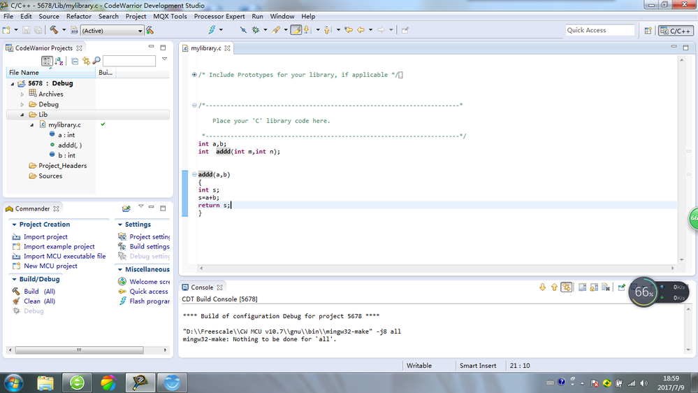

Hi.
Excuse me, My MCU is 56f84789, and my version is codewarrior 10.7, how do I create library functions in codewarrior 10.7? and how can I call my library functions ?can you tell me in detail? thank you very much.
Best regards.
Chuhua guo
3,536 Views
guochunhua
Hi Jennie
I have created a lib project, and wrote my lib file as follows
but there has no header file, I can not declare it in header file(.h), how can I do ? can you give me a video which  show me how to create  library functions and how to call it? thank you very much.

ZhangJennie
Hi Chuhua,
1. In CW 10.7, we can create library with wizard, just select "library" for project type.
2. after creating the lib project, write your functions in source code and also declare it in header file (.h)
3. copy the generated .lib and .h to user project folder.
4. add the lib path to user project "properties", "settings", "DSC Linker", "input", "Additional Libraries"
Please follow above steps and see how it works.
