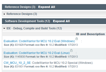

BlackNight
Got to www.freescale.com/cwmcu10.
It is in the download tab (CodeWarrior for MCUs (Eclipse IDE) - ColdFire, 56800/E DSC, Kinetis, Qorivva 56xx, RS08/S08, S12Z Pr...
There expand the Software and Development tools part:4872_4872.png
