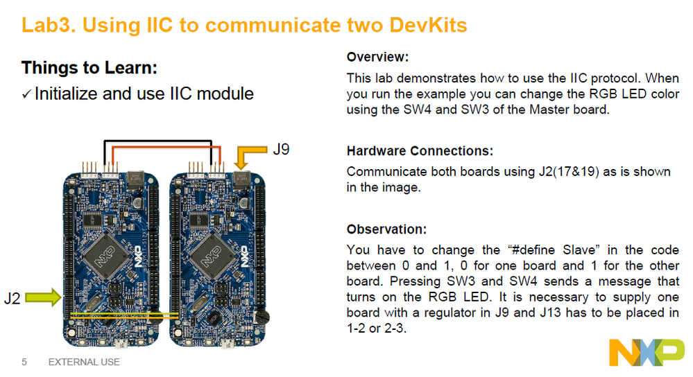

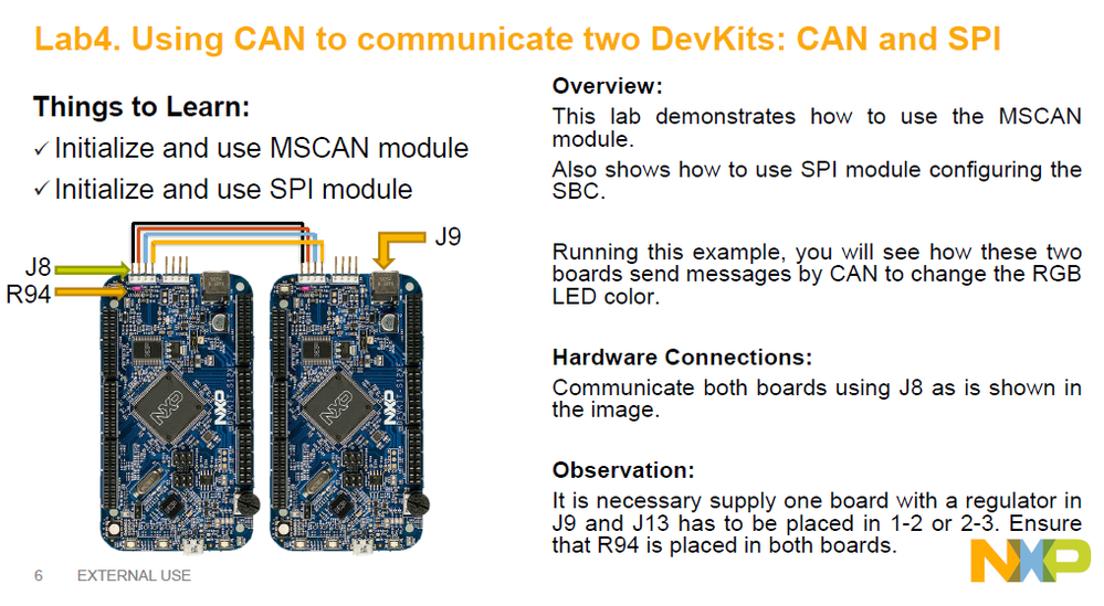

christinar
Yes the comments in the code are very helpful but I want to test the funktion of the code/board. Do I need two boards which are connected? (If yes, is it the same for testing CAN?)
In the description of DEVKIT-S12XE is an example for I2C/CAN. Maybe it´s similar to the S12ZVC board?
Description LAB3 and LAB4 DEVKIT-S12XE:
Thank you in advance.
Kind regards
Christina

ZhangJennie
Yes, You'd better have two boards to test the communication.
Jennie Zhang
