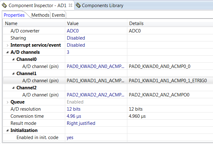

I have a question regarding the ADC block in Processor expert. I am using CodeWarrior version 10.6.4 and the microcontroller is part of the MC9S12ZVC family and I am using a USB multilink universal debugger to communicate with the same. In the processor expert it gives me an option to get all the values for the channels configured and store it in an array or read a specific channel. But it looks like only 1 channel is read every single time, when I step into the function it doesn't look like it is even checking for the channel number.
Here is the configuration I am using for my ADC.

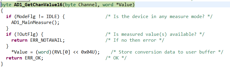

Below is the code generated by processor expert when I use the AD1_GetChanValue16() function -
As mentioned it does not seem to use the channel number variable, which leads to me getting the same value no matter what variable I pass.
I am calling the AD1_MeasureChan(0) function before calling the Get chan function in polling mode. Am I using the wrong function to read the ADC's ? Also, are there any particular register's that I need to enable for this to work ?

Hello Mahendra,
Thanks for contacting us !
I have checked your question , your ADC component configuration lack of one step about
the "A/D samples":
After you configure this , you can use the function of "AD1_GetValue" to read ADC result :
Hope it helps

Thanks a lot Alice! That solved my problem straight away.
