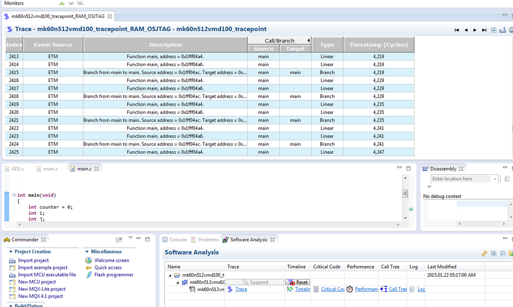

Hello .
I refer to the "Profiling and Analysis Users Guide.pdf" test the trace and tracepoint function,
while I can not understand the trace view , could you tell me how to read this ?
Thank

Hi Linda,
The Trace View can be used to see the collected  trace information from your application, the information will be displayed as a ‘table’ with the instructions executed.
Here is what each of the fields in the table means:
Index. Displays the order number of the instructions.
Event Source. Displays program trace messages from ETM (Merlin) or special messages from ITM.
Description. Displays detailed information about the trace line.
Source. Displays the source function of the trace line if it is a call or a branch.
Target. Displays the target function of the trace line if it is a call or a branch.
Type. Displays the type of the trace line, which can either be a linear instruction, a branch, a call, or a custom message.
Timestamp. Displays the absolute clock cycles that the instruction takes to execute.

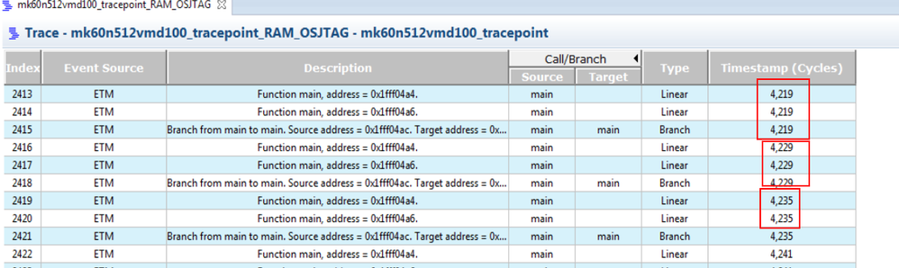

Fan_xy
Hi Carlos,
About the "Timestamp" , is it the  clock cycles that the correspond instruction ? or it is the clock cycles that from the first instruction to there ?
If the first assumption is right , why some instuction's time is same ? like this :
