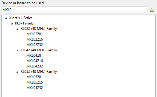

I work on Codewarrior with a microship kinetis : MKL03Z16 . And, when i generate a new bareboard project, it asks me on wich microcontroler i want to work :
i can get the MKL04 , but no MKL03. I though both micro were close enough to work with the other startup code, but i was wrong. i need the MKL03Z16 startup code. Does anyone knows were or how to get it? i searched for few hours and didn't find anything.

Hello Adrien Segura,
CodeWarrior doesn't support this chip. Recommend you use the latest Kineits support IDE MCXUpresso IDE:
MCUXpresso IDE|Eclipse-based Integrated Development Environment (IDE) | NXP
This IDE is free and official supported.

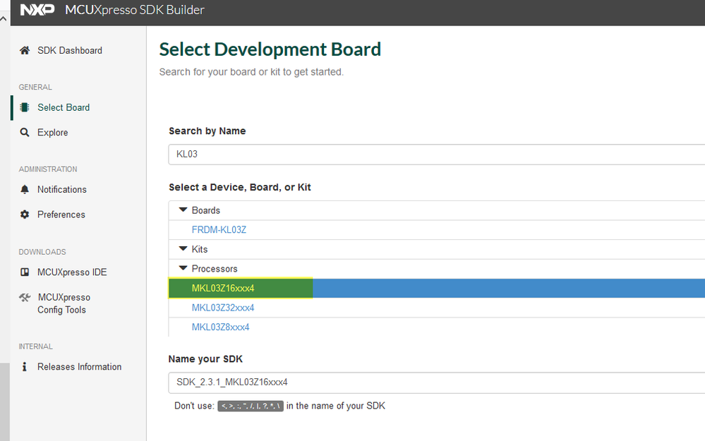

With this IDE, you need download SDK for KL03:
https://mcuxpresso.nxp.com/en/select
About how to use it , please refer to "MCUXpresso_IDE_User_Guide.pdf", I attached it for you.

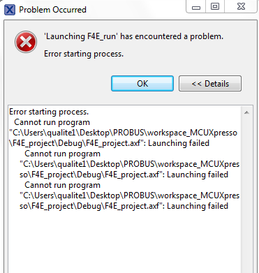

No problem with the downloading or installing the features. But still, when i try to launch the startup program , i got this error :
"cannot run program" and "error starting process". And i don't know where does it come from, any ideas?

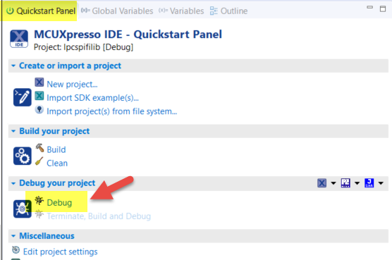

adrien_segura12
Hi Alice,

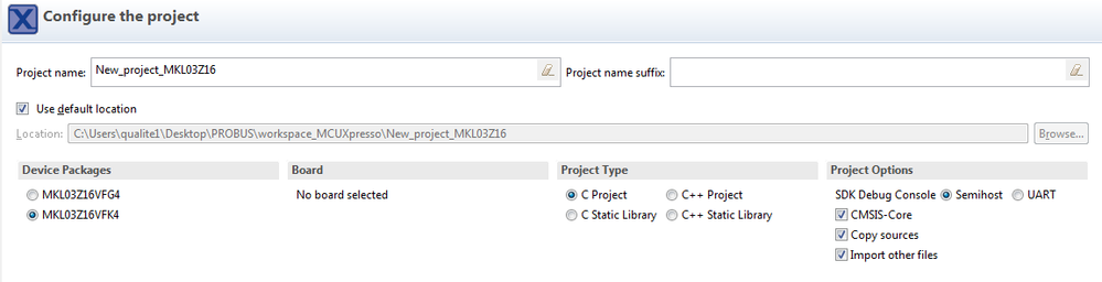

So, i added the  additionnal SDK library, from here, i created a new project :
then i choose my SDK library with my ship :
i used in the tab below every fonction i use for my project : UART, lptmr, GPIO etc... and then i click on finish.
my project is created successfully :
when i debug it, i got no problem.

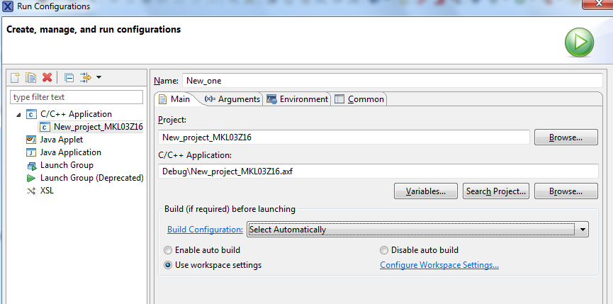

then time to run it : i go on run configurations and create a new one and let the settings as default :
i also tried with a build configuration on "use active" or "debug", it does not change anything.

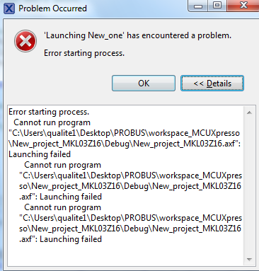

and then i run the program :
and there it is, i don't understand why it does that.
But, i tried to flash the program, and it worked. i don't fully understand the difference between those two, but the flash worked.
do you have any ideas? thanks a lot !
(also , as a debug probe, i use a multilink universal which is correctly detected and used by the flasher)
Adrien
6,232件の閲覧回数
Hello Adrien,
Please use the Debug button under Quickstart Panel to debug the project:
And there is a suggestion, we'd better use the Buttons under Quickstart Panel when using MCXUpresso IDE.
Hope it helps,
TIC
