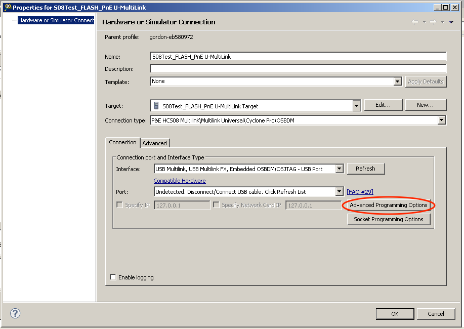

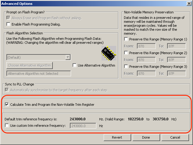

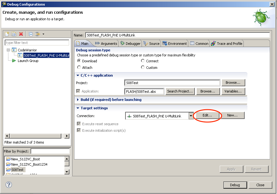

In CodeWarrior Development studio the on-chip reference is automatically trimmed and programmed into Flash each time a debug session is initiated and code downloaded into the target. To change the default trim value select "Debug Configurations..." from the drop down menu next to the debug icon in the toolbar:
In the resulting dialog, click on the "Edit..." button in the Target settings area:
In the next dialog box, click on the "Advanced Programming Options" button:
In the final dialog box, use the trim options at the bottom to set a custom trim value:

I knew that method, but the problem I think is that it is programming a file with debug information. Also, I assume CodeWarrior is enabling some configuration to debugging through JTAG. Am I wrong? Therefore, I think it is not the way to flash for production.
Abraham
3,276 Views
Hello Abranham Paz,
Change Trim Value , CW only support the method with debug mode as Gordon Doughman said.
Codewarrior is a IDE, its main function is build, debug code.
And you can use debug mode change trim value, then use "Flash file to Target” to download your project.
