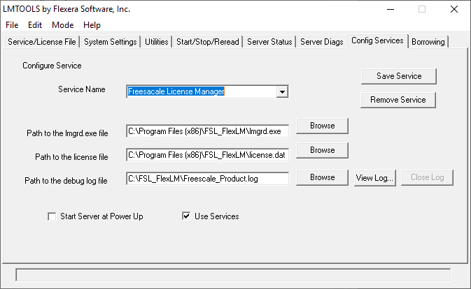

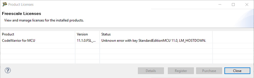

After Migrating to windows 10 floating license is not working in client machines.
I was using code warrior floating license in windows 7. After migrating to windows 10 license is not working in client machines. I have followed all the steps as per the floating license installation guide lines and all the necessary settings has done in LMTOOLS.
In the host server license is working fine. But client Machines License is not accessible.
3,095 Views
TomasPaez
Make sure the license file is being seen by CW app, MCU subfolder is the default location.
I also suggest to create a new service on the server Side, on Config Service Tab you can type the name of a new server and set up the service again.
Check the following community on also checking that lmgrd is running
