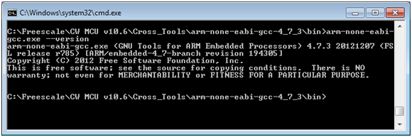

CW10.6 's compiler is gcc ,so  the gcc version is the compiler version.

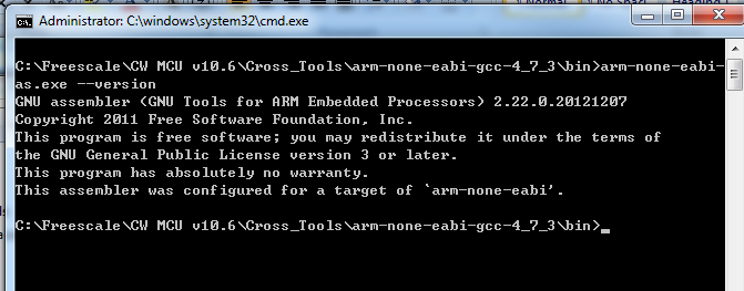

And the Assembler version is check the "arm-none-eabi-as.exe" version like this :

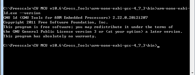

And the linker version check the"arm-none-eabi-ld.exe"
And you show is the c/c++ compiler version.
