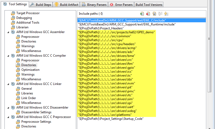

Starting development with a FRDM-KE02Z40M brd.  I have installed CW 10.6 and am attempting to learn it.  I simply want to be able to Import and Copy some of the example projects to my designated workspace.  When I do this, ALL of the project source(src) files become warnings and essentially are not found.  However, if I just Import (without copy), then the source files are OK.  I am importing examples from the Freescale/CW installed directories.  When I look into the Project Settings Linked Resources, the ones that are marked as Invalid Location(src files), the "Resolved Location" is a non-existent src folder that is located 3 folders above my designated project workspace folder.  Why is it doing this and how do I fix it?

Hello greg:
That behavior is expected. Those source files are linked to the project. The linked files can be identified by the little arrow in the icon and also the linked folders have a small white square.
This means that those files and folders are somewhere else instead of the project's folder, but their location is known by the project.
When you only import the example project to your workspace, then you are leaving the project in its original location in the file system and the links are still valid.
However when you "copy" the project to the workspace, only the project folder is copied and not the linked files/folders. This effectively breaks the links.
If you want to "copy" the projects, then to fix the links you have some options:
1) Create your own folders structure and copy the missing files from the example's folder. Then in CodeWarrior remove the problematic files and drag-drop your own copied files. I think this is the best option, as you now have full control of the project and can easily export it to a different computer.
2) Edit the "Linked Resources" locations. They need to point to the folders in CW installation (...\CW MCU v10.6\MCU\CodeWarrior_Examples\Kinetis_Examples\KE\src).
3) Recreate the same folder structure copying the files of the examples, so that your copied project can "see" them at the same levels than the original project.
I hope this helps.

Sorry Gregg, my first suggestion was not accurate, the procedure is more complex. I will summarize the steps here (you did the first 2 steps correctly):
:smileyinfo: Again all this complexity is to copy one of the installed example projects with linked files. You would not have to struggle with other projects.
1) In CW delete the src folder with the broken links.
2) Copy the entire src folder from the examples directory to the copied "project folder". The project folder is the one that has the .project and .cproject files inside.
3) The src folder has source files for ALL the example projects, so many of the files are not relevant for the specific project you imported. This will cause build errors, so you have to delete such files from the src folder. Easiest way to do this is to import the original example project in a different workspace and check which files are used by the project (you can open a second instance of CW IDE).
4) Once you deleted unnecessary files, right click on the copied project in CW and select "Refresh". The src folder should now appear, as in the next image:
5) Go to [Project -> Properties -> C/C++ Build -> Settings ARM Ltd Windows GCC C Compiler -> Directories] and fix all the paths related to the src folder (e.g. instead of "${ProjDirPath}/../../../../src/common" you should have "${ProjDirPath}/src/common").
Then the project should build with no errors.

Jorge, I found a simple satisfactory way to copy the projects and build without error.  Similar to what you suggested, instead of copying the src folder from the example projects into my unique project copy, I placed it where by default (according to the pre-defined linkages) it was expecting to see it.  It's "resolved" location.  As long as I Import/Copy to the same common workspace, the projects can now find all the copied sources.
