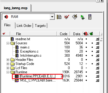

The code that compiles MPC5554 with codewarrior2.10 does not support the division of long long variables.
Long long a = 10;
Long long b = 3;
Long long c = a/b;
error at compile time -  __div2i is not defined.
How should I do it?
975 Views
stanish
Since mpc5554 is 32bit MCU there is no hardware instruction for long long division.
Therefore compiler uses routines emulated by software. Long long routines are part of Runtime library (e.g. Runtime.PPCEABI.E.UC.a)
Please make sure this library is included in your project.
Hope it helps.
