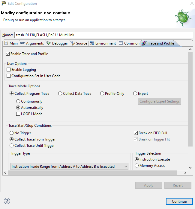

Hello All --
I am still developing a project using a 9S08QE128, CW 11.1 and a P&E Cyclone Pro.  The program worked well until it overflowed into banked memory.  I have managed to recover, mostly, and it was showing signs of life until the other day when it started locking up.  Some investigation revealed that the program is running properly for a few to several seconds, and is then jumping to RAM or the peripheral register space, and trying to execute code there.  The program halts at that point, but CW is unable to give me more than the program counter.
I am trying to use CW's Trace.  I would like to have it break on any reference to an address in a range, with the range defined as 0x0000 to 0x207F.  I would like it to stop on any address in that range, and then step backwards to find out where it went astray.
I have found the process to set up the Trace, and the option to select "break on any address within range", but there is no way to enter the desired addresses.
I'm sure I'll have more questions, but I will start with, How do I tell it what range of addresses I am interested in?

kef2
Senior Contributor V
Hi again,
CW11.1 is fine for address range breakpoint. Perhaps not the best way but here's how:
1. You will need to enable trace. As well you may need to change trace settings from time to time while debugging. To do so from debug session in the top left Debug window select and right click item starting with "HCS08, <project name>" string. -> Edit <project name>_FLASH_PnE U-Multilink...-> Trace and Profile tab, the edit the settings like in the screenshot
Depending on what you are chasing you need to choose the right setting for Trigger Selection. Memory Access (read) will trigger on code execution as well.
2. You may wonder where you could specify A and B addresses. You can do it from Memory, Disassembly or code, In code window right click on gutter then Trace Triggers, then Toggle Trace Trigger A or B. In Disassemble window right click on address. In Memory window first add Monitor, then right click on memory cell you want to place trigger at. You may as well Window->Show View->Other...->Software Analysis->Analysis points. In that view you may add or remove points A and B.
Hope it helps

GaryOlmstead
Senior Contributor I
It helped a little.
I read the DBG section of the manual.  in CW, I selected Run-> Debug Configurations... and set the Trace & Profile screen as above. I set it to trigger between A and B.  I selected Debug. It stopped at main(). The DBG registers had not changed.  I stepped one instruction, and the DBG registers had been set up to what I believe are the right values (DBGCA = 0x0000, DGBCB = 0x207e, DGBF = 0x644B, DGBT = 0x87, all others zero).
  I restarted the program.  It ran and halted at address 0x48.  DBGCNT says there are 8 values in the FIFO, but how do I get them out?  The DBG section of the manual rather blithely says to use the BDM commands, but Run -> Debug History... just asks if I want to start over, and none of the other menu choices looks even remotely helpful.  P&E Micro says they don't do anything with the DBG module except set break points.  So where are they?
