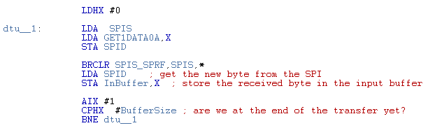

I do something like that (family MC9S08)
With this method you only send the constant table GET1DATA0A (OutBuffer). I have to do something with the possibility to choose the constant table.
