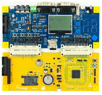

MAPS-K22 brief description:
- High performance Freescale ARM Cortex™ M4 SoC MK22FN512VLL12 with 120MHz core clock, 512KB Flash and 128K RAM.
- Support Graphic LCD by Flexbus interface.
- Power supply from Micro USB 5V.
- Support ISO7816 smart card by UART interface.
- Support connector for Peripheral, Application and Socket MAPS board.
- SDK 1.0 Software release

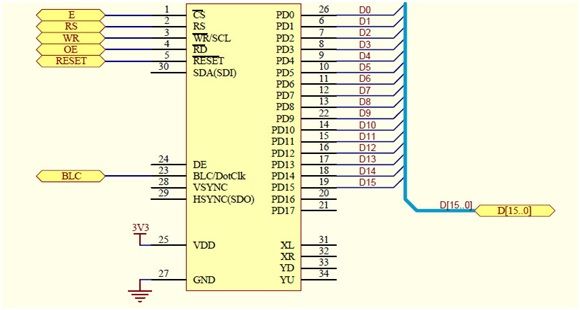

Block diagram

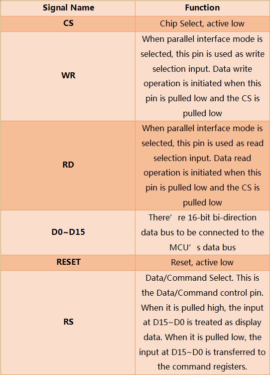

Pin functions

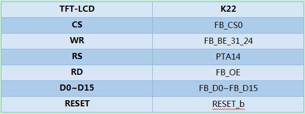

Pins allocation

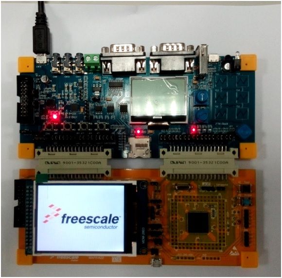

Demo illustration
After run the demo, the TFT LCD will display the Freescale logo as below, and I’ve also attached the demo.
Welcome to download it.
