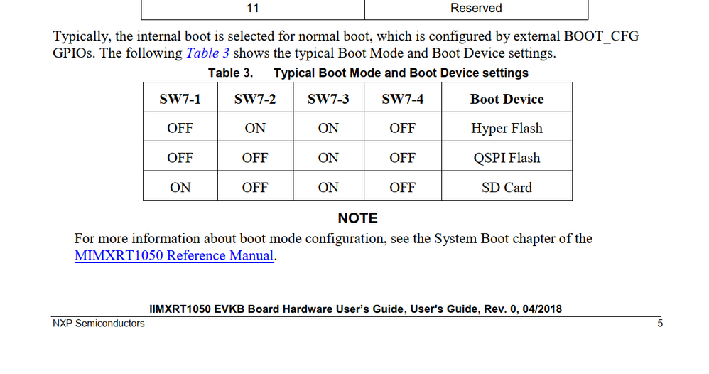

To use the QSPI Flash on the i.MX RT1050 EVK, you must swap zero ohm resistors on the bottom side of the PCB.   The schematic indicates which resistors need changed, however this modification can be difficult because:
1.)   The silkscreen on the PCB is difficult to read.
2.) The RT1050 EVK manual schematic does not mention that the zero ohm resistors for HyperFlash/QPI share a common pads.   Combined with #1,  it makes it difficult to figure out the proper physical configuration.
Here is a photo of the modifications for correct QSPI operation.
Also,  the bootheader will need to be modified to be able to XIP from QSPI.   Using the bootheader from the RT1020 EVK examples will work.    The code below can be used as a replacement for evkbimxrt1050_flexspi_nor_config.c
