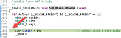

This is related to my last post but it deserves its own attention.
Running SCB_DisableDCache(); after turning on the cache (e.g. after BOARD_ConfigMPU()) causes it to get stuck in a loop for a loooong time (30 seconds +).
It seems to be this way on all optimization levels (I tried O0, O2, Og).
I created a new sdk project (I chose evkmimxrt1064_lpuart_edma_transfer) with sdk 2.10. Added
Should be easy to reproduce.

jeremyzhou
Thanks for your reply.
According to your statement, I place two breakpoints just like the below figure shows.
I've not encountered the issue that the code will stick in SCB_DisableDCache(), even I change the hello_world's memory allocation, I use the SDRAM instead of SRAM_DTC as primary RAM.
The attachment is my demo code.
Have a great day.
TIC

steve_n
Yes, using a break point after the SCB_DisableDCache() will have no issues.
You must use the Step Over function. Don't set any breakpoints and step over each function, when you step over SCB_DisableDCache() it will get stuck. Hopefully you will see the same.
I downloaded your code and did re-create it, with LinkServer and PE Micro Multilink FX.

steve_n
Sorry for the poor description. Let me clarify. The actual function call SCB_DisableDCache(); is the problem. Stepping over SCB_DisableDCache() takes about 2 minutes to complete.
To recreate: use mcuXpresso 11.4 with SDK 2.10.0 with MIMXRT1064xxxA. Create a new hello_world SDK project for the MIMXRT1064-EVK.
Add SCB_DisableDCache(); before the printf line. Debug the project and step over each line. Stepping over SCB_DisableDCache(); will take 2 minutes.
Here is an example of the code:

This issue is discussed at https://github.com/ARM-software/CMSIS_5/issues/620
On line 2322 of core_cm7.h of SDK 2.10, it appears an attempt is being made to overcome this issue, but it doesn't seem to work.
Additionally, due to the issue I describe in this post ( https://community.nxp.com/t5/i-MX-RT/GCC-Optimization-Level-broken-by-core-cm7-h-in-SDK-2-10/m-p/135... ) the GCC Optimization levels are broken on all SDK 2.10 that uses core_cm7.h
