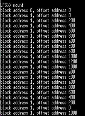

Next, create two new c files, lfs_sdmmc.c and lfs_sdmmc_bridge.c. The call order is littlefs->lfs_sdmmc.c->lfs_sdmmc_bridge.c->fsl_sd.c. lfs_sdmmc.c and lfs_sdmmc_bridge.c acting as intermediate layers that can connect the LITTLEFS and SD upper layer drivers. One of the things that must be noted is the mapping of addresses. The address given by littleFS is the block address + offset address. See figure below. This is a read command issued by the ‘mount’ command. The block address refers to the address of the erased sector address in SD. The read and write operation uses the smallest read-write block address (BLOCK) of SD, as described below. Therefore, in lfs_sdmmc.c, the address given by littleFS is first converted to the byte address. Then change the SD card read-write address to the BLOCK address in lfs_sdmmc_bridge.c. Since most SD cards today exceed 4GB, the byte address requires a 64-bit variable.

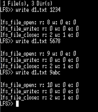

But after more testing, a problem was found, if you repeatedly add->-close->-add-> close a file, the file will open more and more slowly, even taking a few seconds. This is what should be added and is not written directly in the last block of the file, but will apply for a new block, regardless of whether the previous block is full or not. See figure below.
The figure above prints out all the read, write, and erase operations used in each write command. You can see that each time in the lfs_file_open there is one more read than the last write operation. In this way, after dozens or hundreds of cycles, a file will involve many blocks. It is very time-consuming to read these blocks in turn. Tests found that more than 100 read took longer than seconds. To speed things up, it is recommended to copy the contents of one file to another file after adding it dozens of times. In this way, the scattered content will be consolidated to write a small number of blocks. This can greatly speed up reading and writing.
