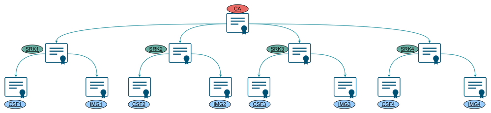

In the installation directory of MCUXpresso Secure Provisioning: ~\nxp\MCUX_Provi_v3.1\bin\tools_scripts\keys, there are scripts for generating keys: hab4_pki_tree.sh and hab4_pki_tree.bat (both are applicable to Linux and Windows systems respectively), running any of the above scripts will generate 13 pairs of public and private keys in sequence through OpenSSL, which constitute the below tree structure.
Fig1 Key Tree structure

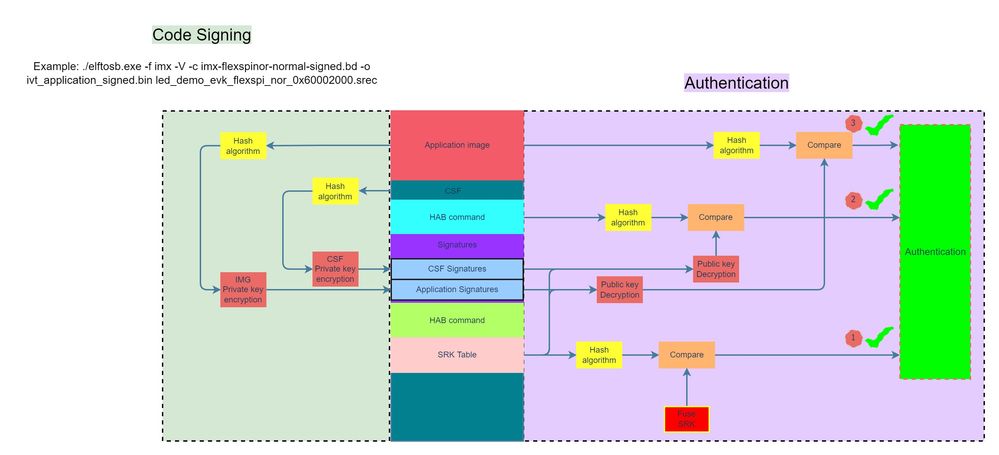

If someone fakes a certificate issued by an authority, it's like having fake ID cards and fake household registration books. To generate a certificate, you need to initiate a certificate request, and then send the request to an authority for certification, which is called a CA(Certificate Authority). After sending this request to the authority, the authority will give the certificate a signature. Another question arises, how can the signature be guaranteed to be signed by a genuine authority? Of course, it can only be signed with something that is only in the hands of the authority, which is the CA's private key. The signature algorithm probably works like this: a Hash calculation is performed on the target information to obtain a Hash value. And this process is irreversible, that is to say, the original information content cannot be obtained through the Hash value. When the information is sent out, the hash value is encrypted and sent together with the information as a signature. The process is as follows.
Fig2 Signature and verification process

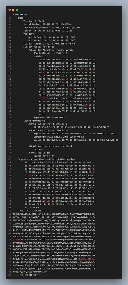

Looking at the content of the certificate (as shown below), we will find that there is an Issuer, that is, who issued the certificate; The subject is to who the certificate is issued; Validity is the certificate period; Public-key is the content of the public key, and related signature algorithm.
You will find that in order to verify the certificate, the public key of the CA is required. Then a new question arises. How can we be sure that the public key of the CA is correct? This requires a superior CA to sign the CA's public key, and then form the CA's certificate. If you want to know whether a CA's certificate is reliable, you need to see if the public key of the CA's superior certificate can unlock the CA's signature. Just likes if you don’t trust the District Public Security Bureau, you can call the Municipal Public Security Bureau and ask the Municipal Public Security Bureau to confirm its legitimacy of the District Public Security Bureau. This goes up layer by layer until the root CA makes the final endorsement. Through this layer-by-layer credit endorsement method, the normal operation of the asymmetric encryption mode is guaranteed. How does the Root CA prove itself? At this time, Root CA will issue another certificate (as shown below), called the Self-Signed Certificate, which is to sign itself with its own private key, giving people a feeling of "I am me, whether you believe it or not", Therefore, its format content is slightly different from the above CA certificate. Its Issuer and Subject are the same, and its own public key can be used for authentication. So the certificate authentication process will also end here.

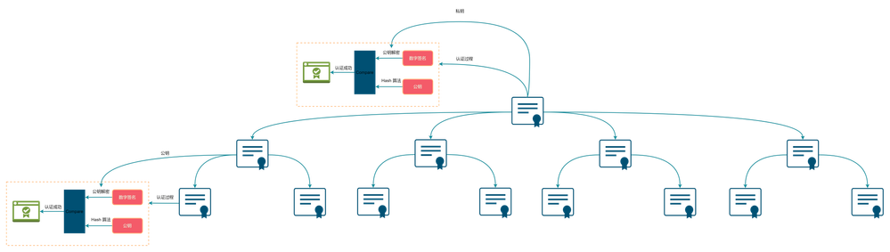

In this way, in addition to generating the public key and private key through running the script, the OpenSSL will also generate the certificate chain shown below.
 Fig3 certificates
