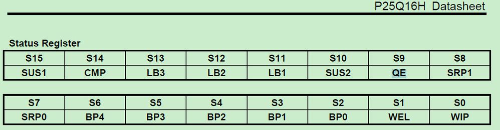

2.2.1 P25Q16H QE position
Fig 1
   We can see, it is still the typical Status register bit 9.

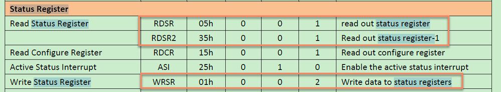

The related LUT write and read commander is:
Fig 2
We can see that for writing, it is command 0X01, and 2 consecutive bytes need to be written. But for the read command, the commands for the two status register bytes are separate. So you need to pay attention to this when operating the QE bit.

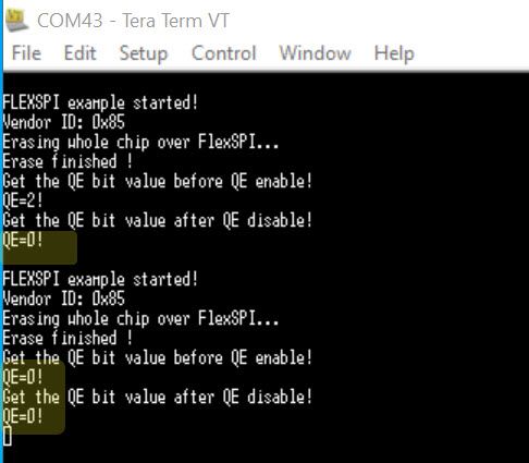

QE position:App.h
#define FLASH_QUAD_ENABLE        0X0200
QE operation:flexspi_nor_polling_transfer.c
 PRINTF("Get the QE bit value before QE enable!\r\n");
    uint32_t QEvalue=0;
    status = flexspi_nor_QE_register(EXAMPLE_FLEXSPI, &QEvalue);
    if (status != kStatus_Success)
        return status;
    PRINTF("QE=%X!\r\n",(uint8_t)QEvalue);
#if 1
    status = flexspi_nor_disable_quad_mode(EXAMPLE_FLEXSPI);
        return status;
    PRINTF("Get the QE bit value after QE disable!\r\n");
       return status;
#endif
   PRINTF("Enable the QE bit value !\r\n");
    /* Enter quad mode. */
    status = flexspi_nor_enable_quad_mode(EXAMPLE_FLEXSPI);
        return status;
        return status;

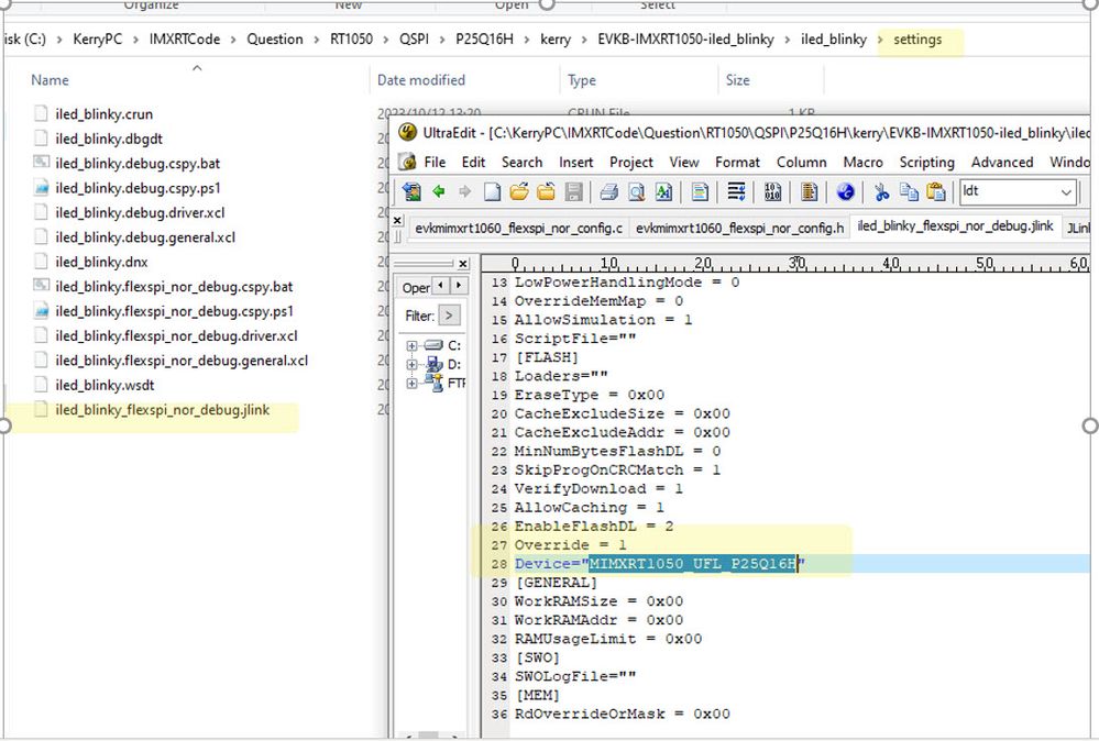

Loop back internally:app.h
#define EXAMPLE_FLEXSPI_RX_SAMPLE_CLOCK kFLEXSPI_ReadSampleClkLoopbackInternally

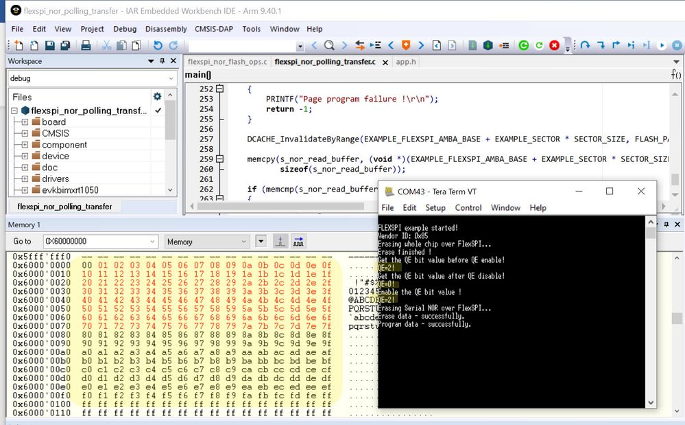

2.2.3 flexspi_nor_polling_transfer testing after modification
Download the modified code to RT1050 RAM and run the results as follows:
Fig 3
From the figure, we can see, QE can normally implement the functions of reading, writing, erasing, and reading. It is read as 2 here which QE is enabled for the first time, because the QSPI in this article has been operated previously. If it is a new chip, it will read 0 by default, which means that QE is not enabled. And it can be seen that after modification, it can accurately erase, program, and read external flash, indicating that the current code modification is successful. LUT, QE position, DQS consideration (60Mhz+loopback internal) are all working.
2.3 APP prepare
Use the led_blinky code in the SDK to mainly modify the frequency of FCB and readSampleClkSrc.

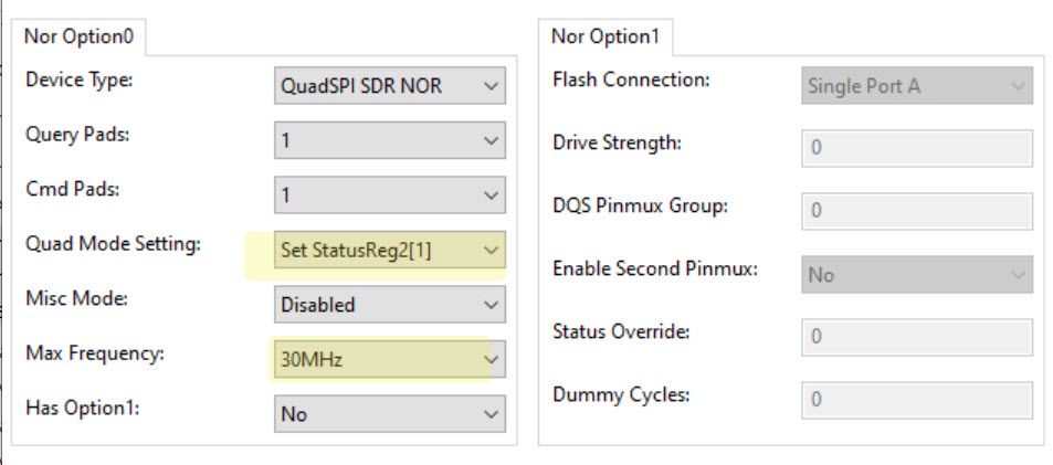

According to the options description, choose:
OPTION 0: 0xc0000201
OPTION 1:0x0
Just like this situation:
Fig 4

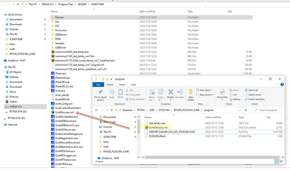

  In fact, just copy: RT-UFL-1.0\RT-UFL-1.0\algo\SEGGER\JLink_Vxxx
To the installed JLINK path: C:\Program Files\SEGGER\JLINKV768B

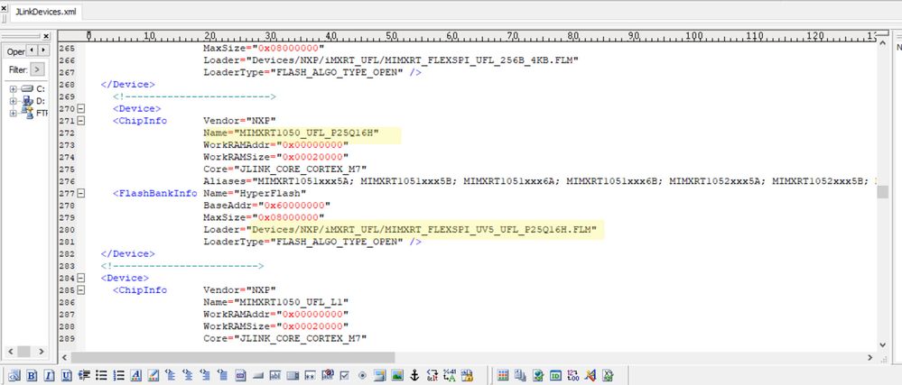

  But this article need to based on this to add the modified flash algorithm for P25Q16H, the modification points are:
1Copy attached file RT1050_P25Q16H_JLINK\program\ JLinkDevices.xml to
Fig 5
The .xml modification is as follows, add the P25Q16H item and it’s algorithm:
Fig 6
Note: device name is MIMXRT1050_UFL_P25Q16H

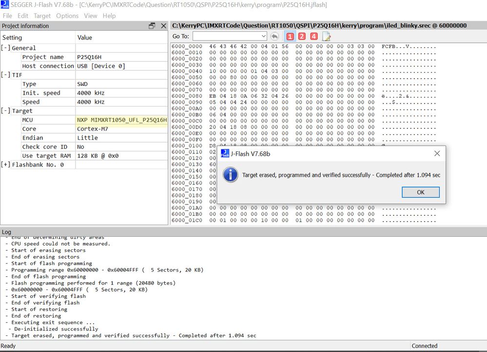

3.3.1 Use JFLASH downloading test
First, use the previously modified EVKB-IMXRT1050-flexspi_nor_polling_transfer, disable the QE bit, to simulate the new QSPI flash chip. The test is as follows:
Fig 8
JFlash test result is:
Fig 9
We can see, use the Jflash with new flashdriver, can program the flash successfully.

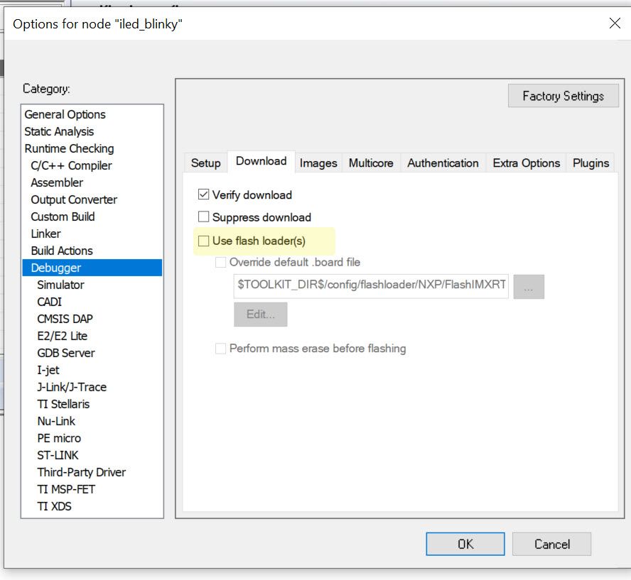

3.3.2 led_blinky app debug test
Disable the QE bit, to simulate the new QSPI flash chip, the test as Fig 8.
APP demo use the IAR project(customer use it), option select JLINK:

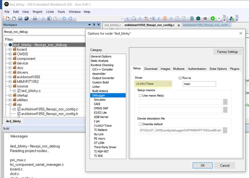

Fig 10
Fig 11
It should be noted here that the device is selected as the modified super download algorithm device name. The method is as follows. The settings->xxx.jlink generated by IAR debug is modified as follows:
Fig 12
Two points: override =1, and device is the new modified algorithm device name.

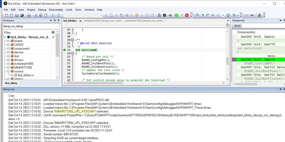

Debug test result:
Fig 13
We can see that the algorithm can be successfully debugged and the algorithm is also modified by UFL.
Run it at full speed and you can see the on board LED is flashing.
It means that all flash driver algorithms, hardware, and codes already support the new P25Q16H QSPI flash.
